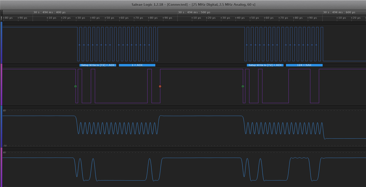

I am trying to get the TMP75 to go into Shutdown mode, but for some reason I am get NAK response.
I write the 0x01 to the devies address which gets an ACK, followed by a variety of values which return NAK. So far any value that isn't 0x01 or 0x02 returns NAK.
I can read data from the TMP75 just fine.
Any suggestions would be greatly appreciated- I am experiencing the same behaviour on multiple chips when using an MSP430FR2433 with Energia on Code Composer Studio

    Can you please take a bus transaction snapshot so that we can check what is happening?

  • Here is a screenshot of a failed transaction in Logic.
  • Hello Jame,
    When writing to the TMP75 the first byte is the pointer byte which is correct and you get an ACK. However the master puts a STOP condition. This causes the next transaction to be treated as a new transaction. When the new transaction is initiated, the byte is being interpreted as a Pointer byte with an illegal value and hence the NAK.
    To correct this behavior you would need to follow the pointer register with the write value to the register without a Stop condition. In other words
    START-0x48-0x01-STOP START-0x48-0x7C-STOP should instead be
    START-0x48-0x01-0x7C-STOP
  • I just realized what I was doing wrong.... completely my fault for restarting the tranmission. And that's why 0-3 was returning ACK.
    Thanks anyway!
