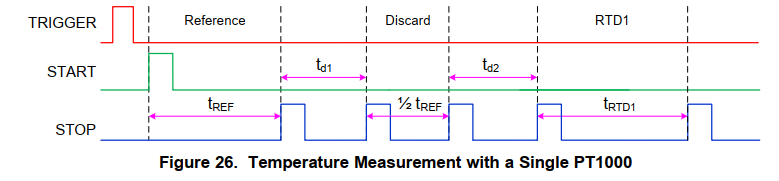

I am trying to measure temperature with TDC1000 and TDC7200 and one RTD. I am changing the CONFIG_2 register to 1 for temperature measurement mode and also configured the chip for a 1kΩ RTD.
The temperature measurement block works at 1 MHz from the TX_FREQ_DIV field configuration in the CONFIG_0 register.

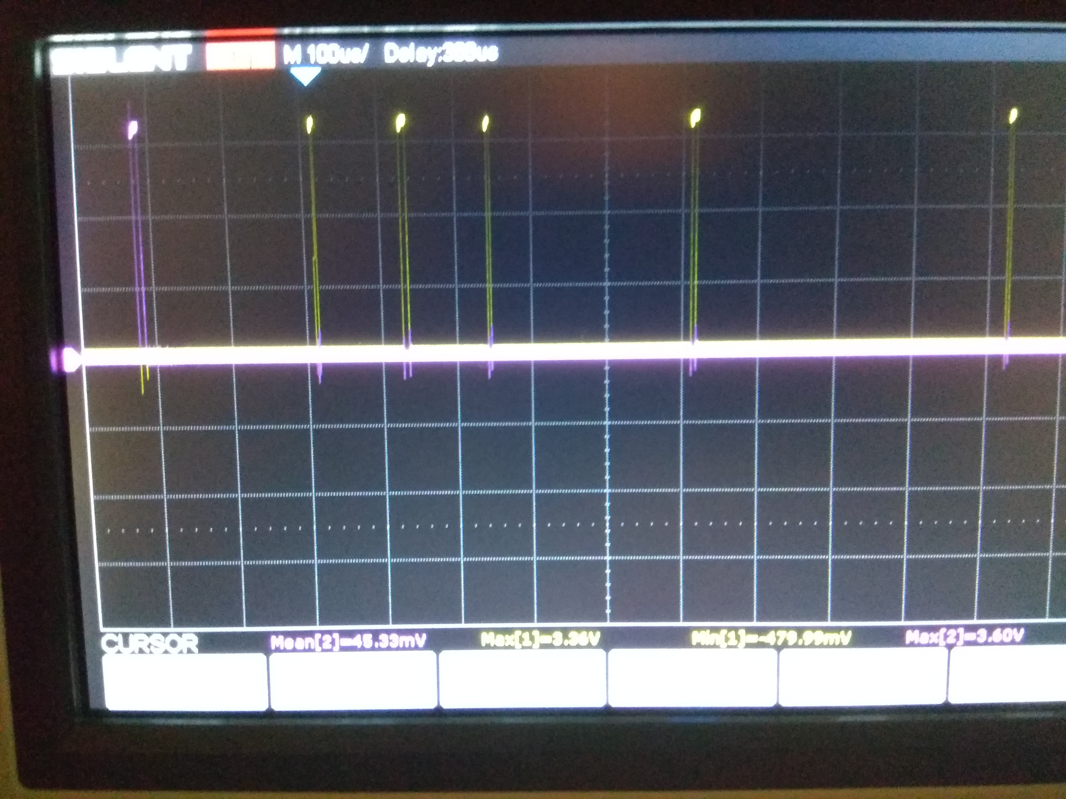

I am getting 1 Start and 5 Stop pulses as expected but the TDC7200 returns wrong results. I am getting a result close to 2kΩ for the RTD which is unlikely.
Are there any other configurations that i neglected to address? I have tried measuring the timings (Figure 26) with the averaging of the results, as the TDC1000 and TDC7200 allow that, but have also tried without any averaging with no luck.
