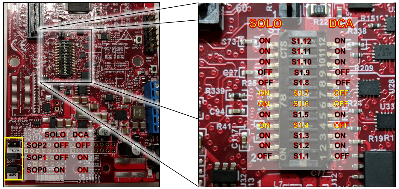

customer has problem to connect to the DCA1000.
- Jumper and dip switches closed (see attachment)
- they use a 5V/3A power supply for each board
- the boards and COM port are identified by the PC
- board reset and connection in mmWave Studio ok
- execution of DataCapturedemo_xWR.lua script ok and BSS FW (3) and MSS FW (4) could be flashed. (version number is updated under infos)
-> then SW hang when connecting to SPI (see attachment). Same if the FW is only loaded manually.
The workaround desribed in the Studio guide ("The SPI Connect button becomes SPI Disconnect indicating a success. If SPI connect does not succeed you may need to erase the serial flash and try again using the Uniflash tool.") doesn't help.

  • Holger,
    From the images that you provided the carrier configuration is incorrect, please look at images below
    Second issue I observed was the matlab error, please make sure that matlab run time is installed according to the 'mmwave_studio_user_guide.pdf' located C:\ti\mmwave_studio_02_00_00_02\docs, on page 6.
    Hope that you find this useful and resolves your issue.
    Alex
  • Hello Alex,
    the SPI connect is working now. The DIP switche were in a wrong possition.
