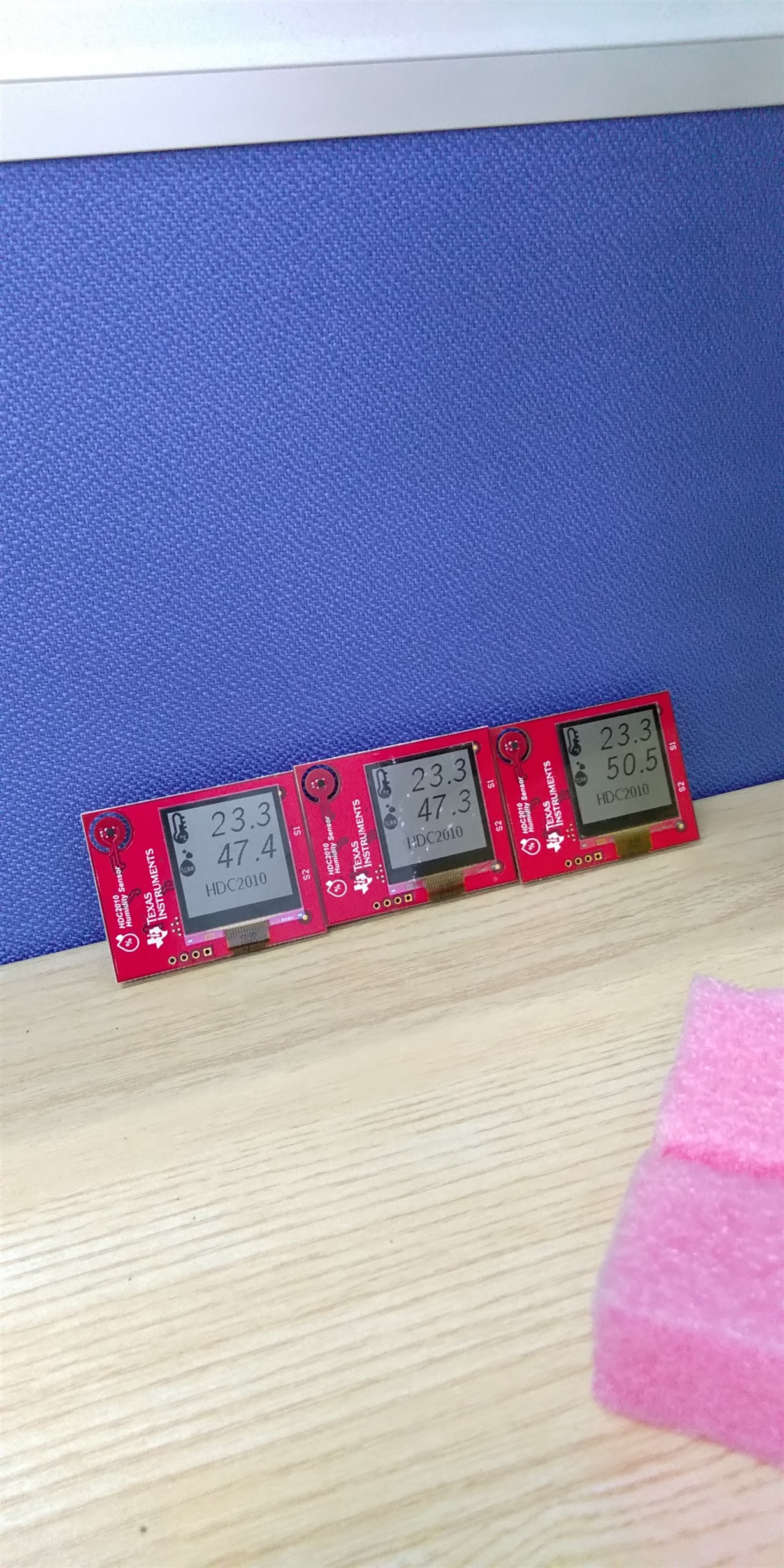

Hello Team
Customer put three EVM board at same situation. their temperature are same, but humidity are difference. I don't know why. So could you give some comment about it? Thanks.
  • Hi Xiao,
    The boards that you are showing in your picture are not the EVMs but a TI design (www.ti.com/.../TIDA-01625), just to clarify. As you may know and can be checked in the HDC2010 data sheet, the max RH (relative humidity) accuracy is +/-3%, which means an overall range of 6% of possible values distributions with respect to the reel RH. Therefore none of the values shown are violating this range.
    The problem will be if any of these values have a difference of greater than 6% with respect to a reference instrument used to compare to.
    Thanks!
