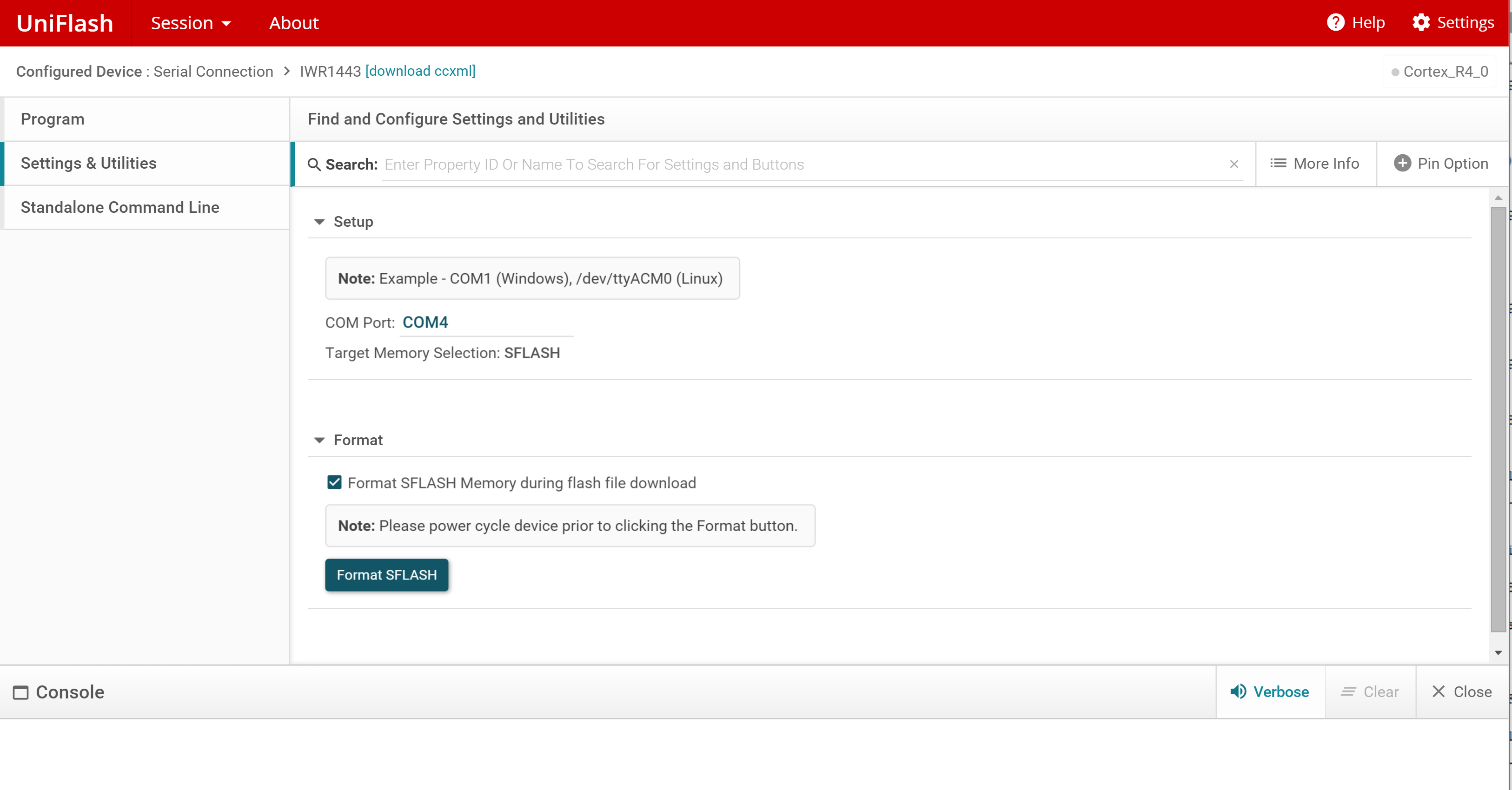

I have a new IWR1443BOOST and new DCA1000EVM that I am trying to get working to collect data through mmWave Studio following the instructions from the training here. I have the two boards connected via the 60-pin samtec cable, both boards powered with separate 5V 2.5A power supplies, and micro-USB & ethernet cables plugged in to the boards and computer (Windows 10) appropriately. The SW3 switch is set to DC_JACK5V_IN on the DCA1000EVM and the micro-USB to the DCA1000EVM is connected to J1 for FTDI interface. The FTDI drivers were installed and all ports were recognized, as seen in the device manager.
The SOP pins on the IWR1443BOOST are set to:
SOP0 | Closed |
SOP1 | Closed |
SOP2 | Open |
After configuring the static IP address for the DCA1000EVM, I launched mmWave Studio 2.0.0.2, and ran the following commands.
When I try to move to the next step (SPI Connect (5)), it fails which I suspect is due to the MSS Firmware being invalid from step 4 above.
Output Log:

I found a related issue here, which was resolved by

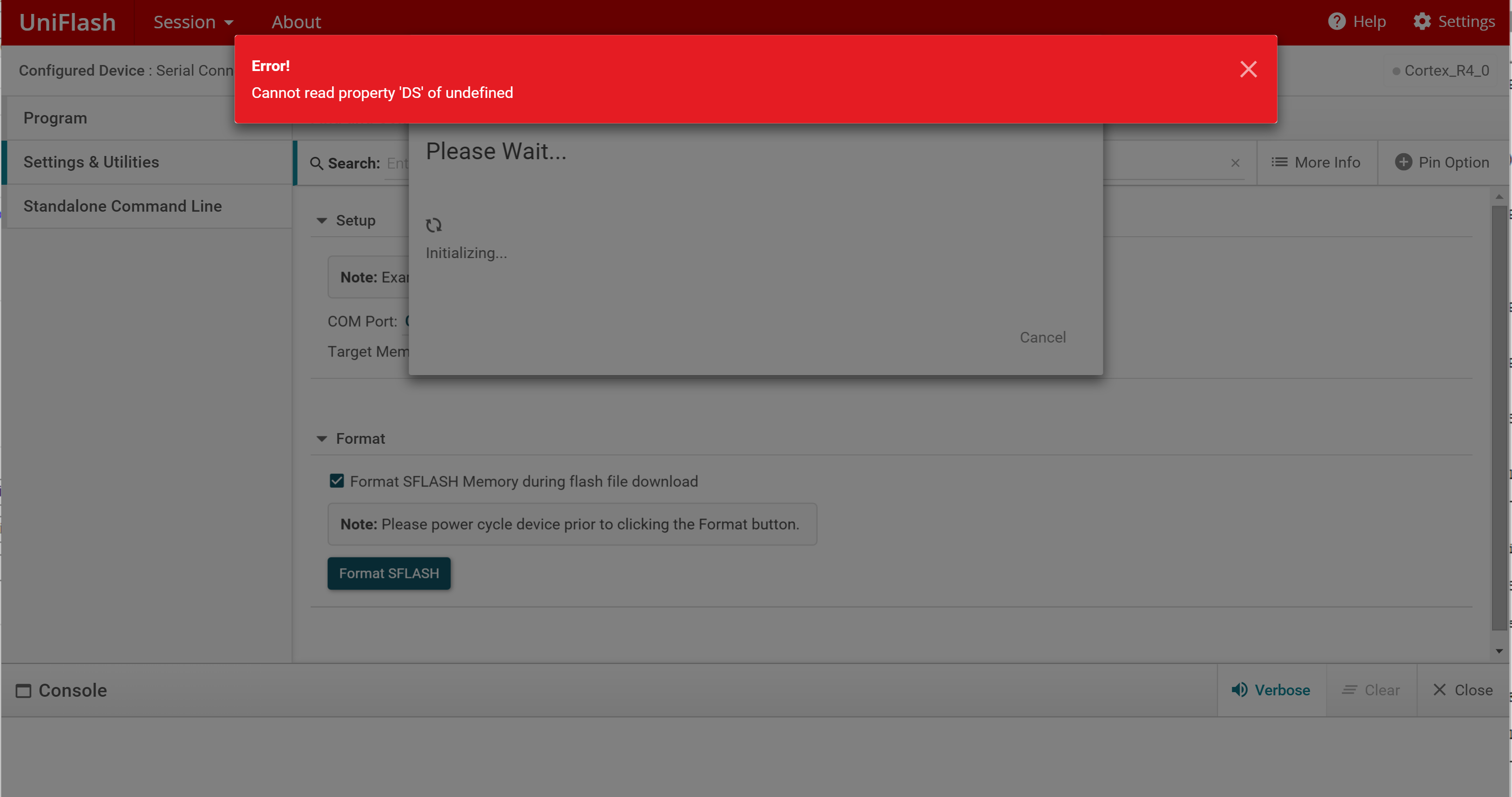

I get the error "Cannot read property 'DS' of undefined" as shown
As I'm just trying to run the demo and following the steps given, I'm confused on what may be causing this to fail so any help to resolve this would be greatly appreciated.

When I'm trying to erase the sflash with uniflash, I'm getting the error "Cannot read property 'DS' of undefined" as before. I have the SOP settings as you described (SOP0 and SOP2 closed, SOP1 open) and have pressed the NRST before trying to format the sflash in uniflash.
Any thoughts on what is causing this error and a solution to it? I found this post that recommended disabling the WiFi and turning off the firewall on my laptop, which I have tried and still am getting the same error.
Kirk
Alex,
Sorry I forgot to respond earlier. My device started communicating with my PC fine without me changing any settings several days later, so my issue is resolved, though I'm not sure exactly how it was resolved. Thanks for all your help getting it working!
