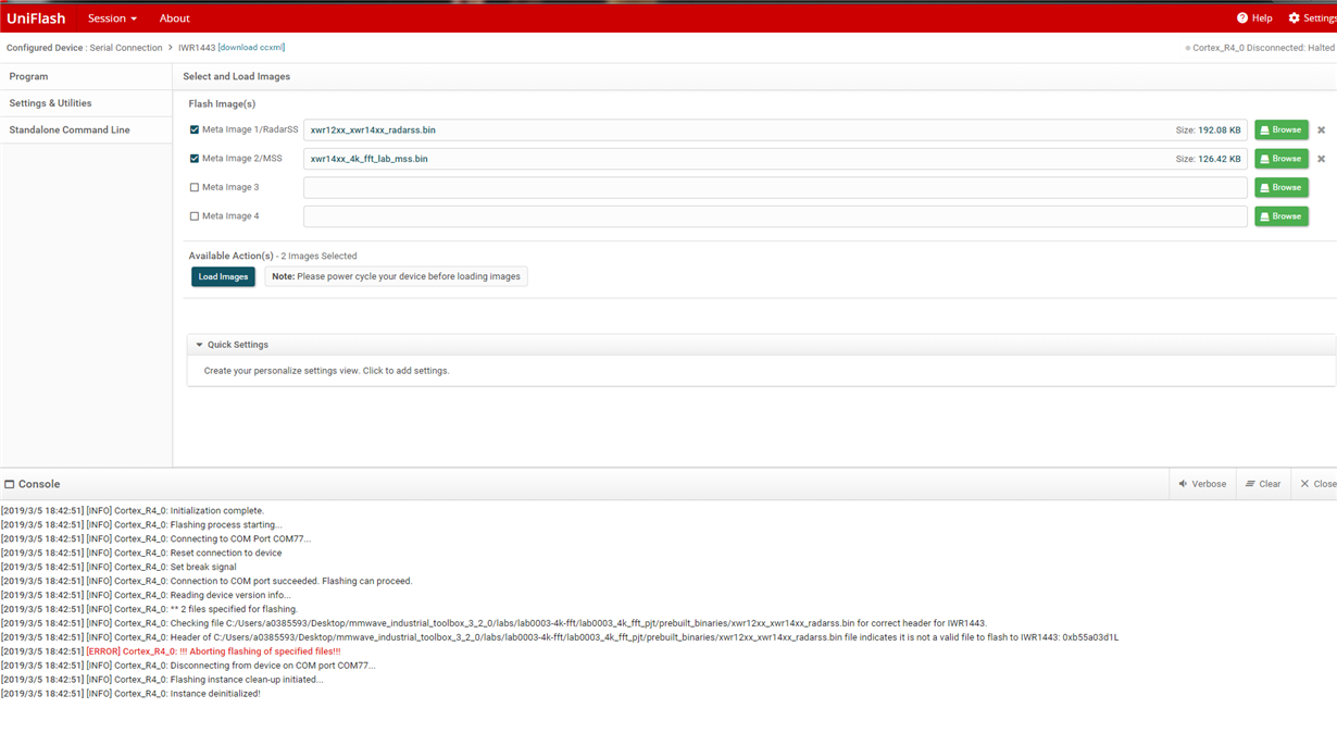

Hi Champs,
We can't flash F/W on the EVM.
This phenomenon is very similar to reference thread.
Here is my experiments
1: Normal flash flow -> failed (encounter bellow error)
2: I tried to several demo binary (high accuracy, vital, out of box , gesture) -> failed same error
2: We also try to flash only "MSS" binary failed. (encounter bellow error)
3:Use Radarss binary from C:\ti\mmwave_sdk_03_01_01_02\firmware\radarss -> failed same error
All time occur same error.
Do you think this is board HW issue ?
<Chip version>
964FC (ES3.0)
<tool version>
mmwave_industrial_toolbox_3_2_0
<error window>
  • Hi Kz777,
    For ES3.0 the only compatible binary right now is the standard SDK demo. We are working on porting all the other labs over to the SDK2.1 for ES3.0 compatibility.
    One thing to note is that on ES3.0 the BSS is flashed in ROM so one needs to flash a patched MSS meta-image (different from normal MSS) but no BSS (radarss) file should be included in Uniflash.
    The procedure for the SDK demo is available here: dev.ti.com/.../
    Cheers,
    Akash
