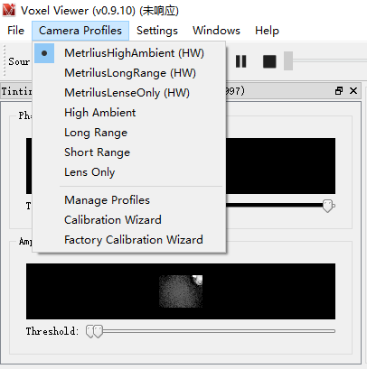

  • Hi Suramya,
    The Voxel Viewer running on Windows can read these profiles shown as below.

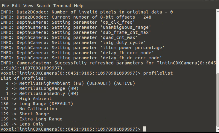

     A built-in profile(MetrilusShortRange) was accidentally deleted when I try to restore the profiles. How can I restore it?
    The VoxelCLI running on Linux can read all the profiles except the accidentally deleted MetrilusShortRange profile, which is shown as below:

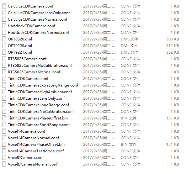

    I can't find any .conf files in the ~/Voxel/conf(Linux) folder except the TintinCDKCamera.conf file. But I can find many .conf files in the Windows ~\VoxelViewer\voxel-sdk\share\voxel-0.6.11\conf folder. Below is a snapshot.
    I wonder if I can restore the deleted or missing profiles to the 8241EVM device. How can I do it? Thank you.

    If the files are not present in the "TintinCDKCamera.conf" file, they won't be visible in Voxel Viewer. Copy the attached TintinCDKCamera.conf (replace .txt with .conf) file to your ~/.Voxel/conf directory on (C:\Users\<username>\.Voxel\conf). That will show the Extra Long Range profile.
    I'm afraid that you won't be able to get the Short Range profile back, which you deleted from hardware.
    If you did take a backup of the file stored in the camera, you can find it in the ~/.Voxel/conf directory with <Serial Number> - <Profile Name>.conf filename. If that's not the case, the camera profile in the camera EEPROM is lost.

  • Jie,
    The calibration parameters are specific to the camera, and you cannot get them back. You would need to re-calibrate the camera.
    The way to go about it will be to use the "TintinCDKCameraShortRange.conf" and change the parent id to MetrilusLongRange (in your case, parent = 2).
    Then, open VoxelViewer and calibrate for Common Phase Offset using the Calibration Wizard. You can find the calibration information from e2e.ti.com/.../640301
    Since calibration parameters are different for each camera, you need to calibrate it manually. The param settings will stay the same as the TintinCDKCameraShortRange.conf profile.
