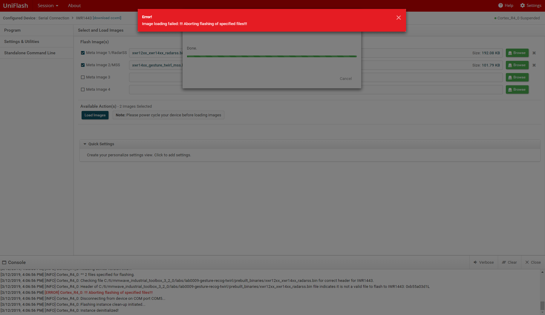

Hey all,
I'm trying to run the labs given in the Industrial Toolbox (v3.2.0) under mmWave Sensors. My device is an IWR1443BOOST, which just arrived so it should be the latest version.
The 'mmWave SDK Demo' works fine but other labs did not. I tried the gesture demo where instruction told me to load the prebuild binaries through Uniflash. But when I tried it, it says the file header does not allow itself to be flashed onto my device. Here's a screenshot:
And here's the console message from Uniflash:

[3/12/2019, 4:06:56 PM] [INFO] Cortex_R4_0: Checking file C:/ti/mmwave_industrial_toolbox_3_2_0/labs/lab0009-gesture-recog-twirl/prebuilt_binaries/xwr12xx_xwr14xx_radarss.bin for correct header for IWR1443.
[3/12/2019, 4:06:56 PM] [INFO] Cortex_R4_0: Header of C:/ti/mmwave_industrial_toolbox_3_2_0/labs/lab0009-gesture-recog-twirl/prebuilt_binaries/xwr12xx_xwr14xx_radarss.bin file indicates it is not a valid file to flash to IWR1443: 0xb55a03d1L
[3/12/2019, 4:06:56 PM] [ERROR] Cortex_R4_0: !!! Aborting flashing of specified files!!!

  • Hi Ziheng,
    The Twirl and Swipe gesture labs have not been ported to run on IWR1443 ES3.0 silicon (which is the production version of the silicon you have on your EVM).
    1. These labs are based on SDK 1.2.x which is compatible only with Silicon revision ES2.0 while the production rev i.e. ES3.0 is compatible only with SDK 2.1 and beyond. You are not able to flash the binaries on your EVM because the binary image format changed between SDK 1.2 and 2.1. So the current pre-built binaries are not compatible with the EVM.
    2. Your CCS build is failing because the lab requires SDK 1.2.0.5 (as indicated in the error message) but you are using SDK 2.1. Even if you install SDK 1.2.0.5, you will be able to compile but won't be able ti run the lab because SDK 1.2 is not compatible with the production silicon.
    -Nitin
