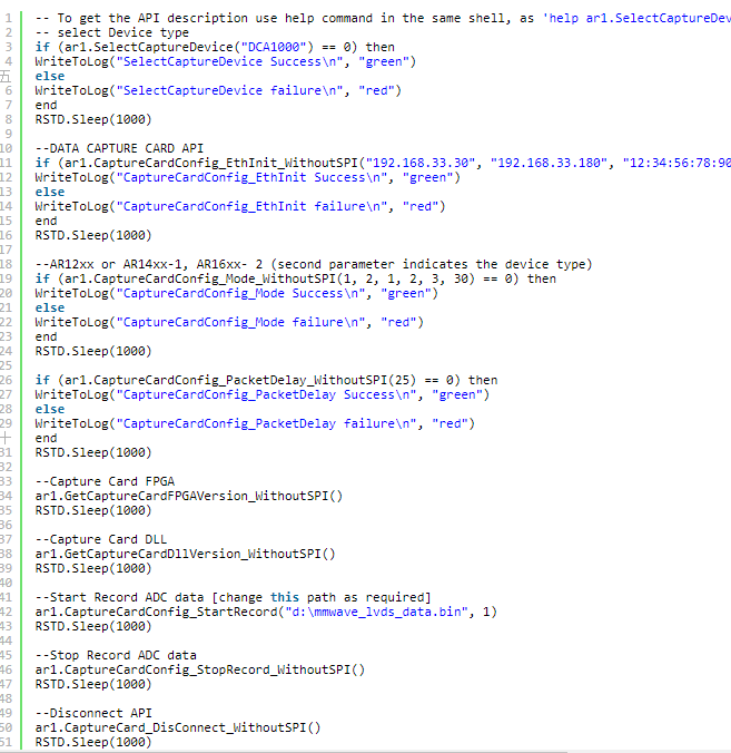

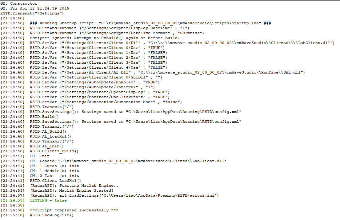

How do I acquire the Range FFT / Doppler FFT / Azimuth FFT using the IWR1642 and DCA1000EVM? Is there a specific process? How should this code snippet work? I have the following output after running luashell. Does this code run every time you open mmwave studio? Which path is the data collected after running this code?
Please watch the DCA1000 training video for steps on how to capture and acquire the plots you mentioned in the post processing window. The luashell output you attached is run every time you use mmWave studio. The image below shows where the data path is set in the code you attached.
