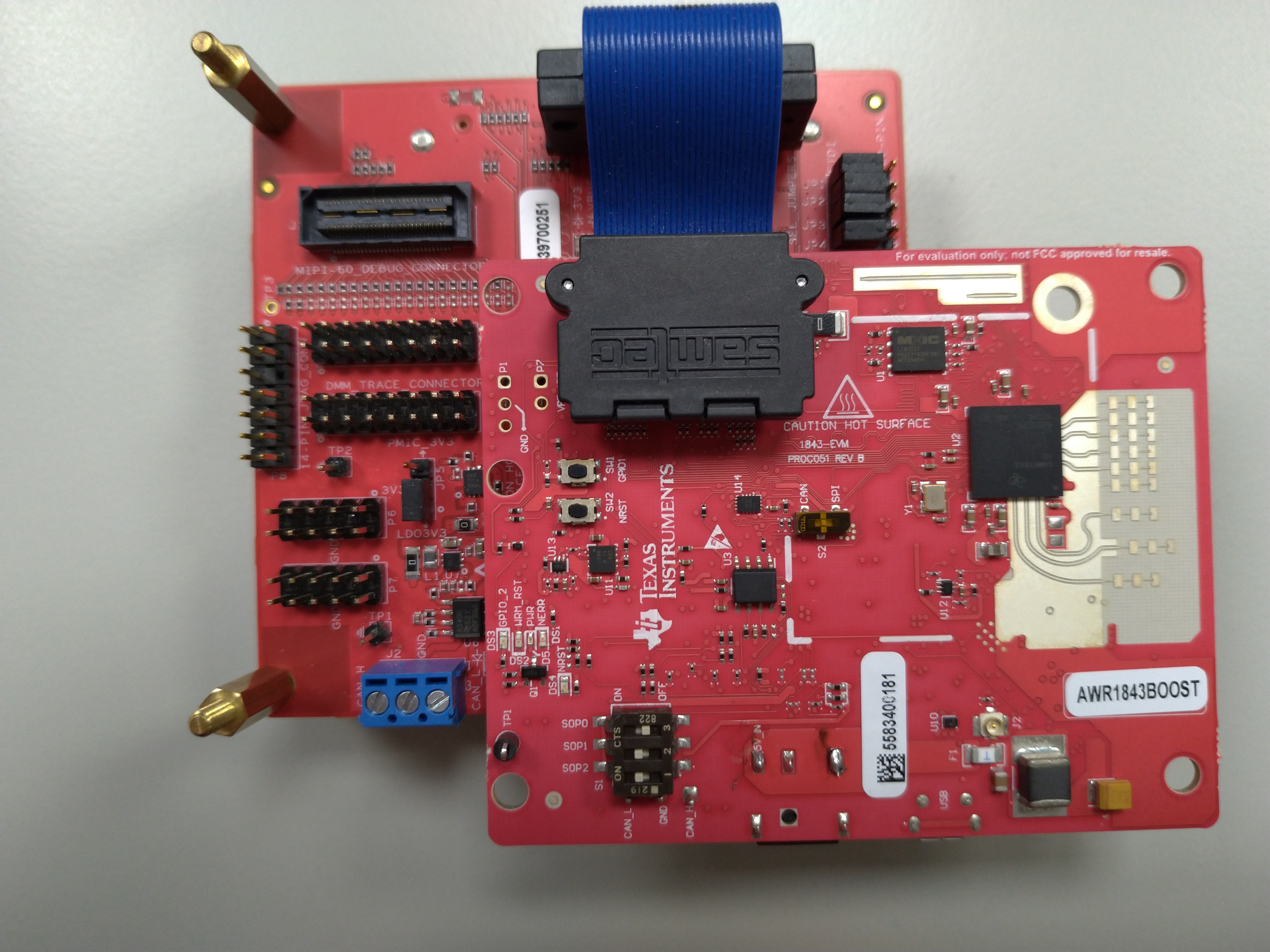

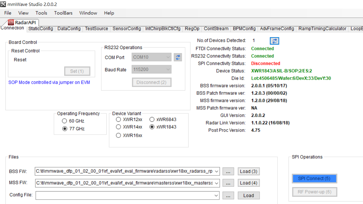

     I can not do SPI connect correctly.
Do I load wrong FW version?

    New version of AWR1843BOOST [RevB] has a switch [S2] option to select between CAN or SPI, by default it is set to ON (selected to CAN).
    For mmWave Studio connection, you need to make S2 switch OFF (select to SPI).
