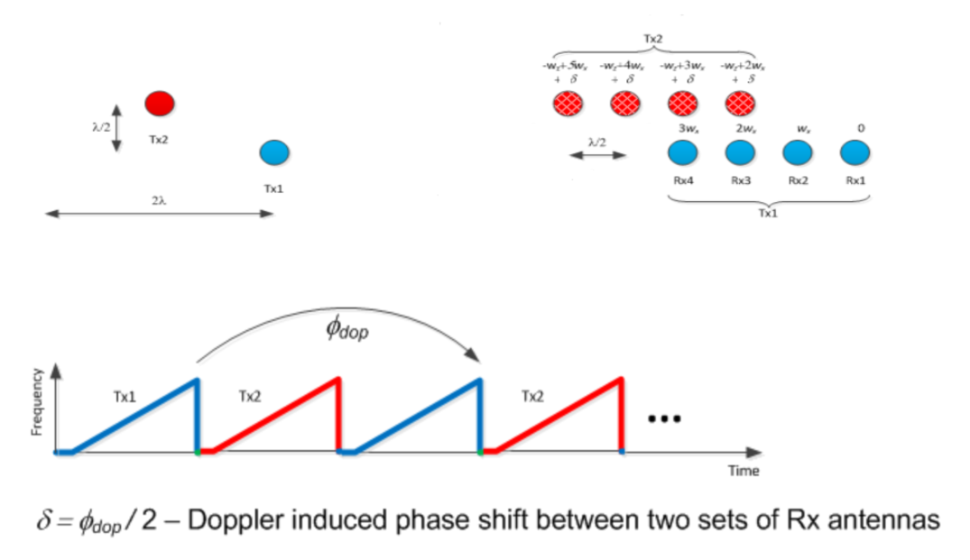

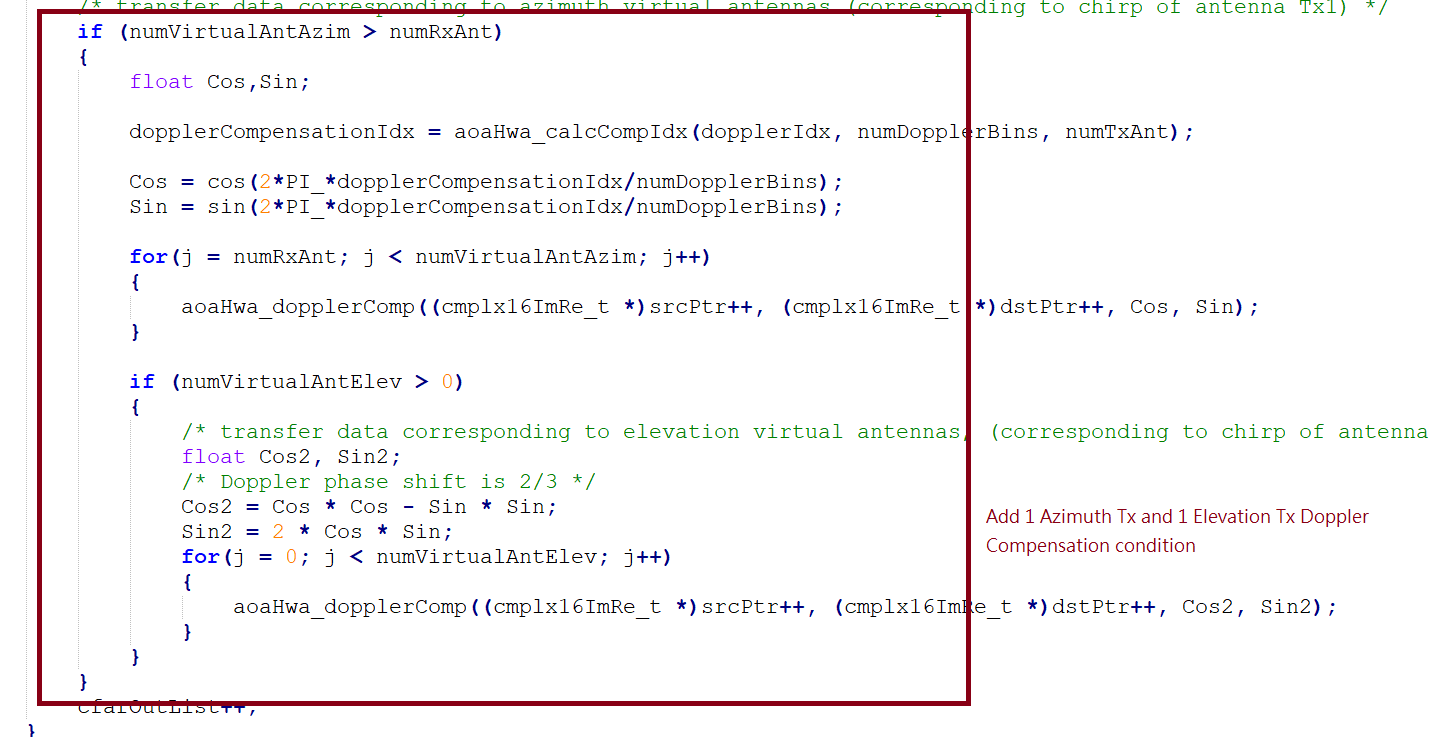

     I modified the AoA code,added doppler compensation for 1 Azimuth Tx and 1 Elevation Tx,

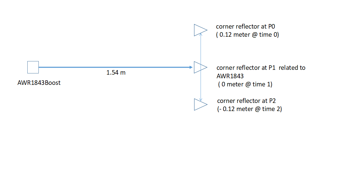

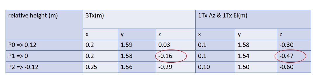

After measurement,I found the initial bias is larger, but the differences of corner height are similiar
(P0-P1 & P1-P2). Is this normal for larger initial bias?
