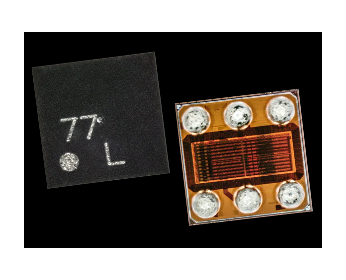

Currently we are facing problems with a product where we are using the PN HDC2010YPAR. The sensor is providing measurements out of the specification, at least for 10 points. We removed one sensor from a failed unit by a new directly form the reel and then passed the functional test. We validate profile in STM, soldering joints on components and check components that are connected to the sensor and not any abnormality there. I can confirm that not exposure to any kind of chemicals, proper packing conditions. Can you share with me a clue of what could be happening?  Any advice from your side?

  • Dear Luis -
    The HDC2010 sensor is on the bottom of the package. Anything that gets in there or obstructs air flow will have an effect on the sensor.
    Regarding touching it - in a clean environment, with ESD protections in place, this could be OK.
    It is recommended to put the sensors in the 30% to 40% at room temp environment - would recommend it be a clean and ESD protected one, too.

  • Dear Luis -
    yes the sensor is on the bottom of the IC, with a cavity - like this
    so - it does need to be protected and allow air flow
    Please see section 2 here http://www.ti.com/lit/an/snaa297a/snaa297a.pdf and on about how to optimize placement of the device, based on where the cavity is located. (HDC2010 vs HDC2080)
