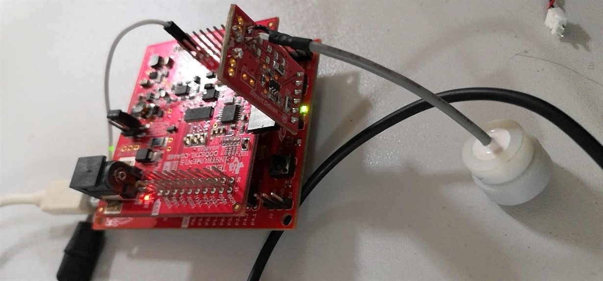

Hi TI team,
     Could you pls help us give some advise for below question?thanks!

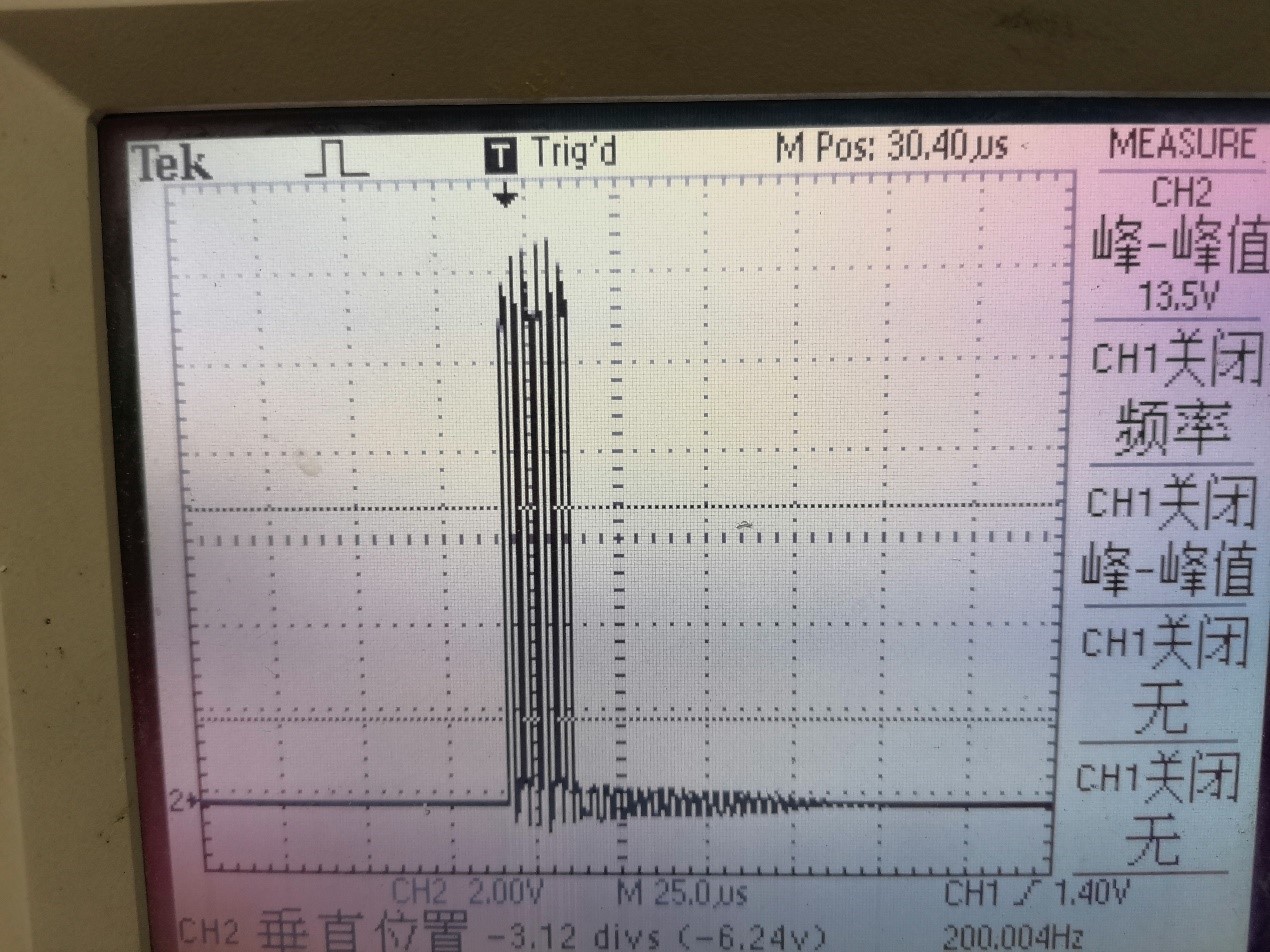

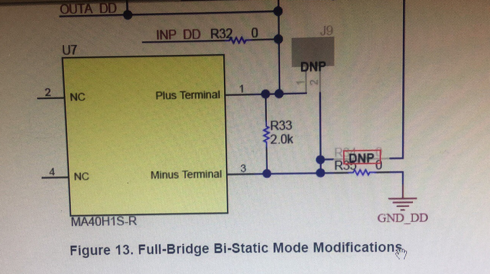

    The software has been configured. Aout of pga460, Bout has been equipped with high-frequency signal output, and the core probe is connected to the drive board, using the direct-driven sub-board. According to the manual, U7 has been removed
Hardware:
  • Sub-board schematic diagram:

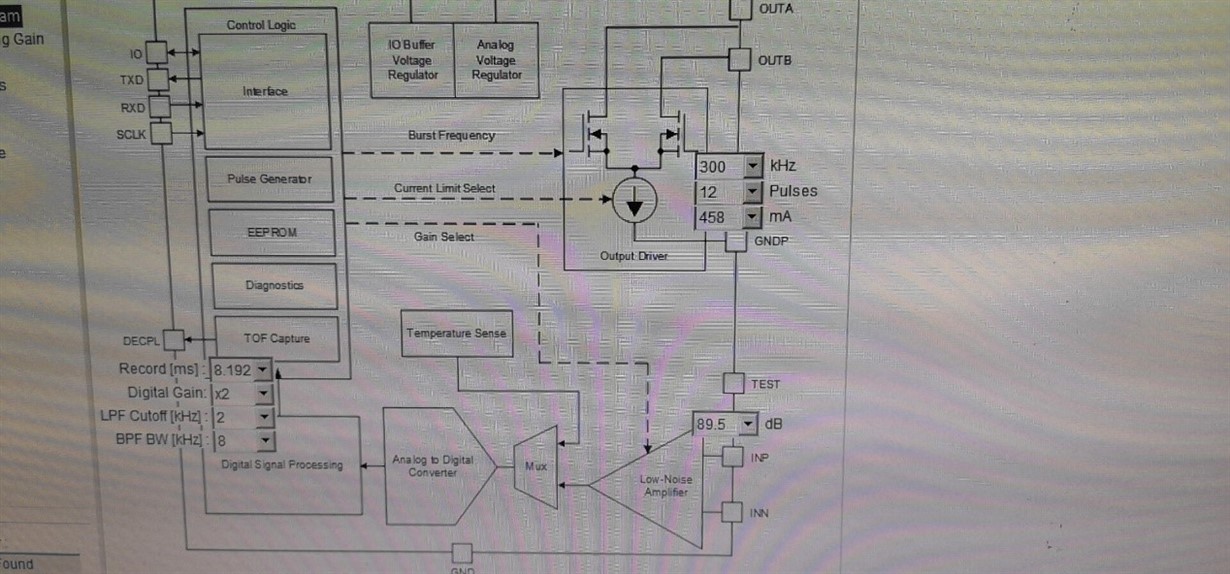

software configuration

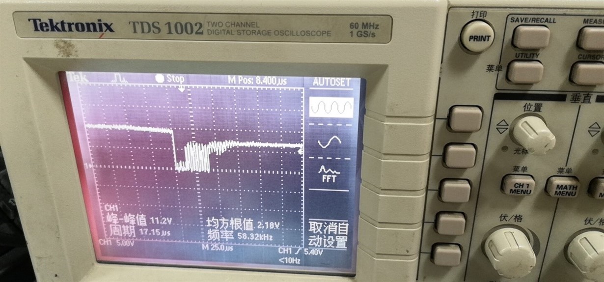

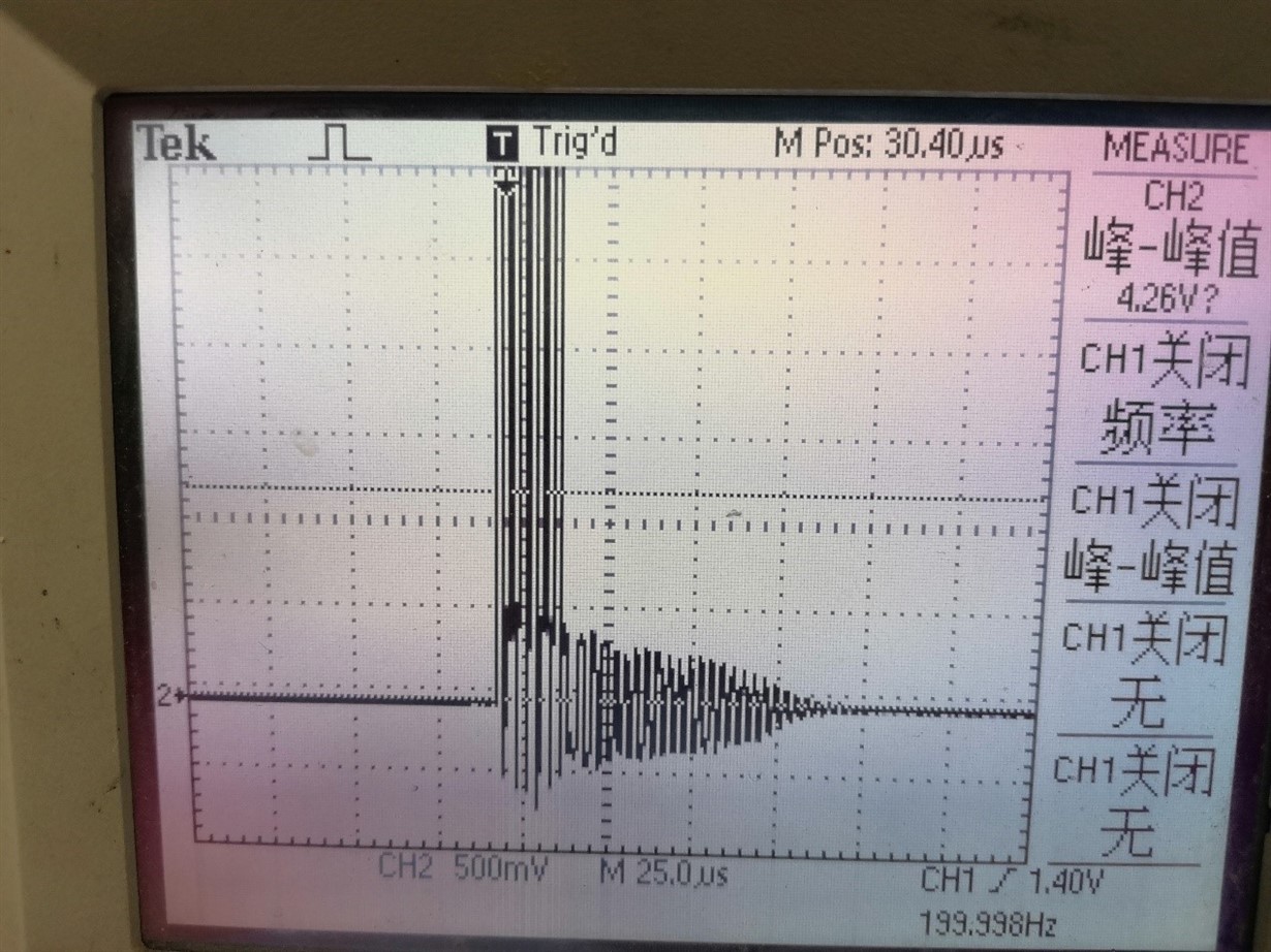

  • Output signal of PGA460 a-out foot:
It can be seen that only PGA460 sends out the pulse signal, and the core probe does not start to work.

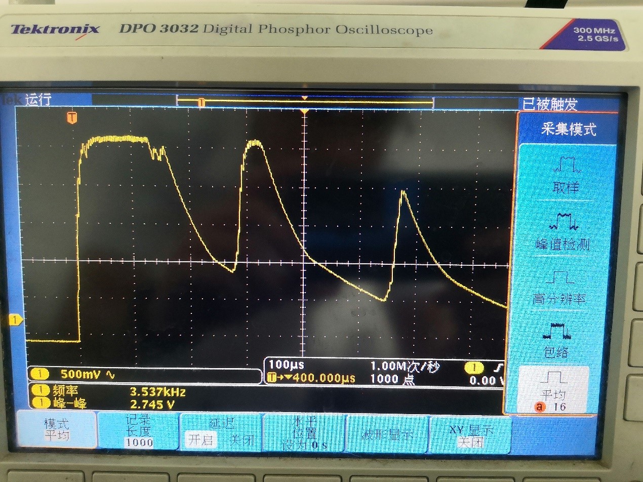

The effect we need:
Aftershock signal + target signal:
  • Hi Jimmy,
    The issue with your modified circuit is that you are attempting to use a mono-static (single sensor) full-bridge configuration, but the PGA460 EVM only supports a bi-static (two sensor) full-bridge configuration. You should use the EVM's original mono-static half-bridge configuration for a single sensor use-case.
    It is possible to enable a mono-static full-bridge configuration using additional external circuitry as described in the "PGA460 Full-Bridge Driver Solutions for Ultrasonic Transducers" app note ( www.ti.com/.../slaa780 ).
