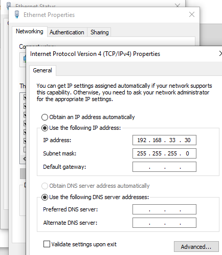

    Did you correctly configure your static IP address correctly? Can you post a screen shot of your IPV4 LAN configuration? It looks like there is a failure with connecting to the DCA1000. The bin file is expected to be empty if you cannot successfully connect to the DCA1000.
    Adrian
  • Hi Adrian,
    As far as I know, I have it configured. I also disabled wifi when testing.
    John
  • Hello John,
    That looks correct. Can you also ensure that you have disabled any firewalls? Sometimes this can prevent the PC from connecting to the DCA1000.
