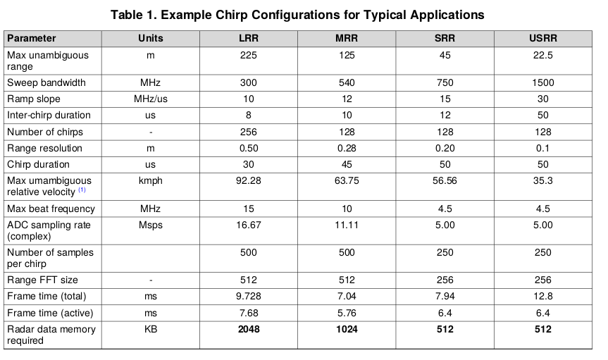

    We have used the MRR parameters from the following table as the SRR and USRR are not usefull for us.
    The detailed parameters are listed in this .cfg file:

    In these settings, sensor works only if we reduce number of samples per chirp to 256 (original 500) and reduce number of chirps to 64 (original 128).
    Could you please take a look at the parameters being used and suggest a solution for this issue.
    For MRR you will need to use the configurations provided with the demo.
    The numbers provide in the tables are based on a processing chain without clustering and tracking.

    Your question is basically why the mmwave SDK 3.2 demo does not work with the MRR configuration mentioned above.
    The reason for that is that the mmwave SDK demo was designed to showcase as many features as possible of the mmwave sensor. For that reason it includes a lot of buffers that can be exported to the host to display in the GUI or save to a file
    Because of this, some of the memory is dedicated to these buffers.
    There is not enough memory to support the MRR use case mentioned above.
    You would need to use the MRR demo I mentioned before for this type of use case.
