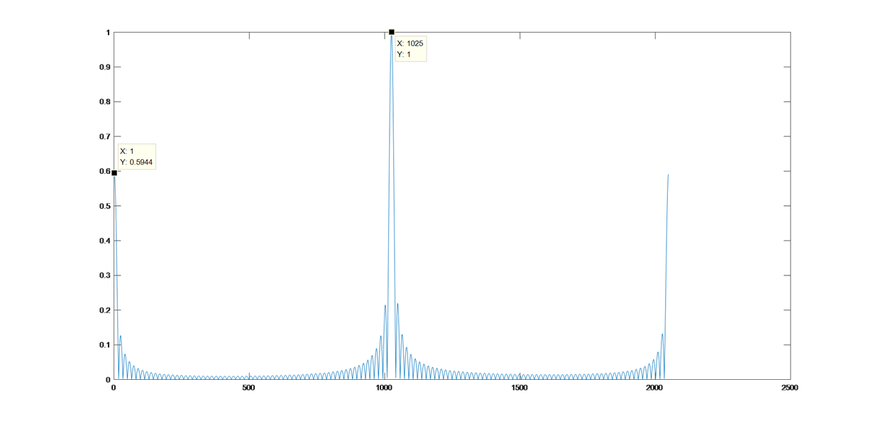

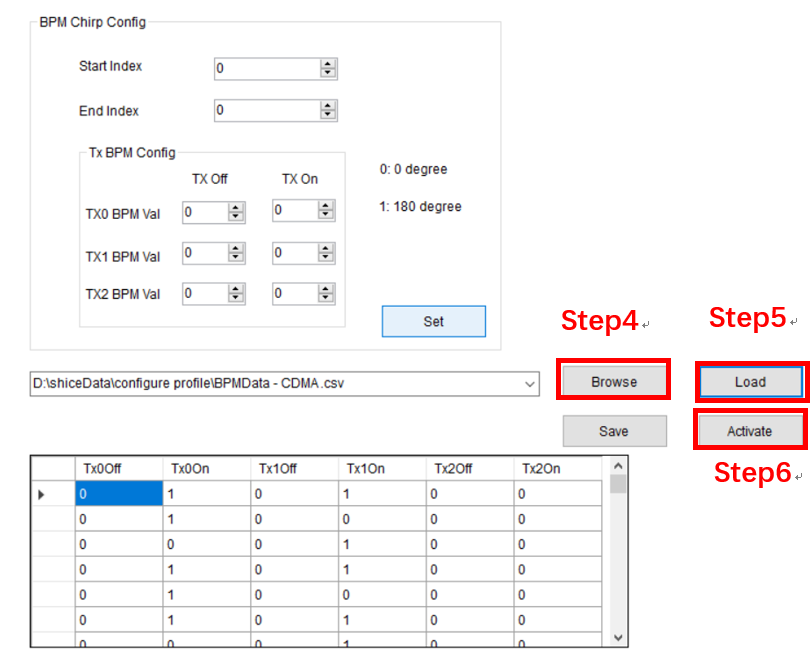

I have some problems about Separating the waveform signals from two transmitting antenna and configuring CDMA.
Firstly,I try to separate superimposed echo signal through  Doppler FFT and I get a velocity plan as below .I want to know if this method of signal processing is right?

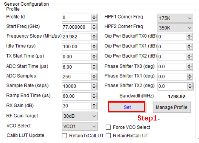

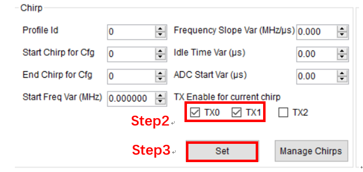

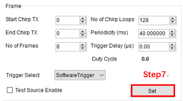

Secondly,I want to know if CDMA configuration process is correct?
