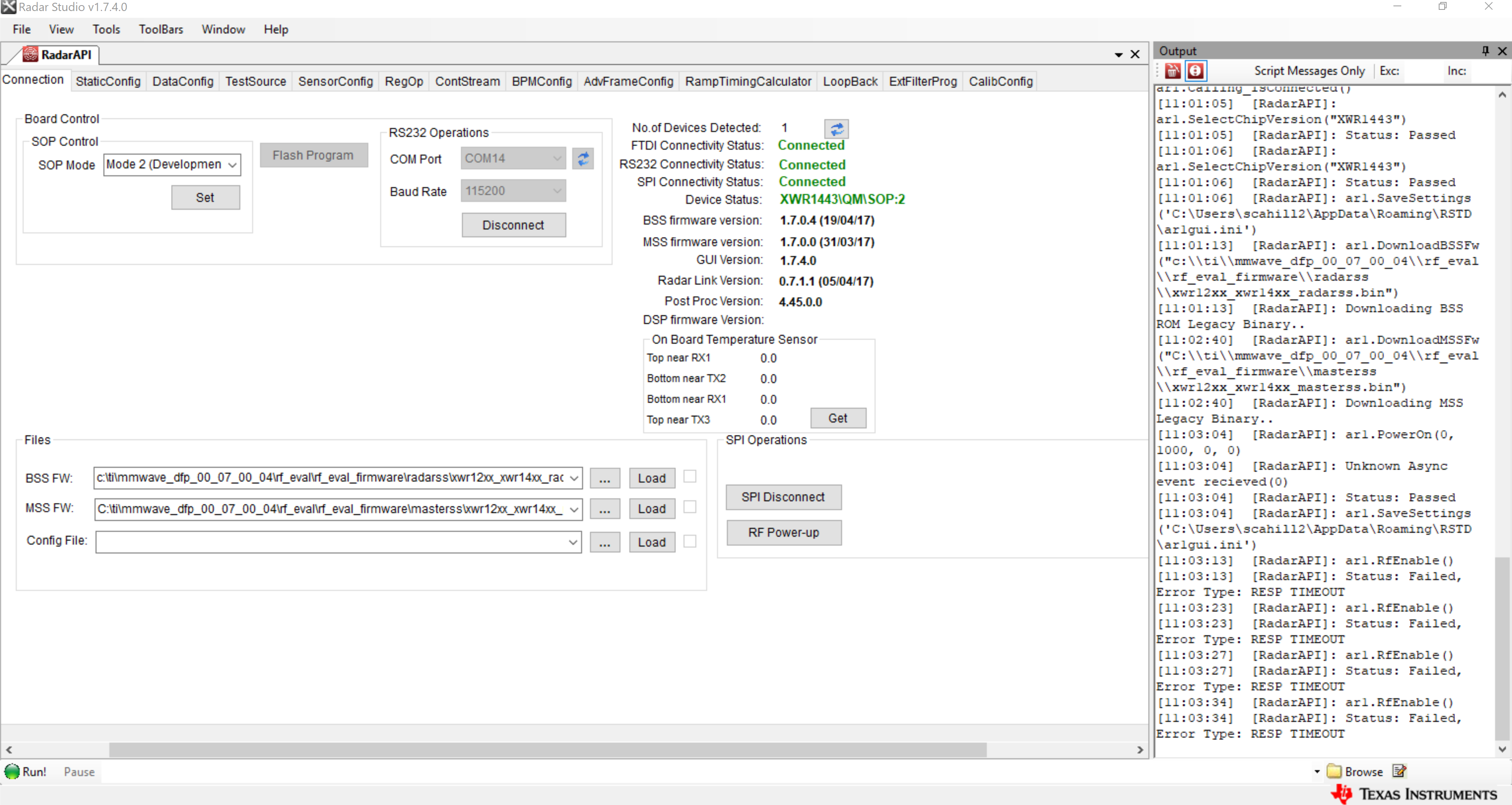

Could someone help with the problem i am facing. I am using Radar Studio v1.7.4.0 with mmwave dfp v07.04 according to the raw data capture presentation located here https://training.ti.com/mmwave-sensor-raw-data-capture-using-tsw1400-board. I am using the TSW1400 Rev D with the mmwave Dev pack and the IWR1443 Boost Rev B.
I encounter a RESP TIMEOUT error when pressing the RF power-up button when trying to connect to the board using radar studio
Below is the text from the output section and attaches is a picture of the UI:

[11:00:20] [RadarAPI]: Starting Matlab Engine..
[11:00:31] [RadarAPI]: Matlab Engine Started!
[11:00:33] [RadarAPI]: ar1.LoadSettings('C:\Users\AppData\Roaming\RSTD\ar1gui.ini')
[11:00:34] TESTING = false
[11:00:34]
[11:00:34] ***Script completed successfully.***
[11:00:57] [RadarAPI]: Opening Gpio Control Port()
[11:00:57] [RadarAPI]: Status: Passed
[11:00:58] [RadarAPI]: Opening Board Control Port()
[11:00:58] [RadarAPI]: Status: Passed
[11:00:59] [RadarAPI]: ar1.FullReset()
[11:00:59] [RadarAPI]: Status: Passed
[11:00:59] [RadarAPI]: Closing Board Control Port()
[11:00:59] [RadarAPI]: Closing Gpio Control Port()
[11:00:59] [RadarAPI]: ar1.SOPControl(2)
[11:01:04] [RadarAPI]: ar1.Connect(14,115200,1000)
[11:01:05] [RadarAPI]: ar1.Calling_IsConnected()
[11:01:05] [RadarAPI]: ar1.SelectChipVersion("XWR1443")
[11:01:05] [RadarAPI]: Status: Passed
[11:01:06] [RadarAPI]: ar1.SelectChipVersion("XWR1443")
[11:01:06] [RadarAPI]: Status: Passed
[11:01:06] [RadarAPI]: ar1.SaveSettings('C:\Users\AppData\Roaming\RSTD\ar1gui.ini')
[11:01:13] [RadarAPI]: ar1.DownloadBSSFw("c:\\ti\\mmwave_dfp_00_07_00_04\\rf_eval\\rf_eval_firmware\\radarss\\xwr12xx_xwr14xx_radarss.bin")
[11:01:13] [RadarAPI]: Downloading BSS ROM Legacy Binary..
[11:02:40] [RadarAPI]: ar1.DownloadMSSFw("C:\\ti\\mmwave_dfp_00_07_00_04\\rf_eval\\rf_eval_firmware\\masterss\\xwr12xx_xwr14xx_masterss.bin")
[11:02:40] [RadarAPI]: Downloading MSS Legacy Binary..
[11:03:04] [RadarAPI]: ar1.PowerOn(0, 1000, 0, 0)
[11:03:04] [RadarAPI]: Unknown Async event recieved(0)
[11:03:04] [RadarAPI]: Status: Passed
[11:03:04] [RadarAPI]: ar1.SaveSettings('C:\Users\AppData\Roaming\RSTD\ar1gui.ini')
[11:03:13] [RadarAPI]: ar1.RfEnable()
[11:03:13] [RadarAPI]: Status: Failed, Error Type: RESP TIMEOUT
[11:03:23] [RadarAPI]: ar1.RfEnable()
[11:03:23] [RadarAPI]: Status: Failed, Error Type: RESP TIMEOUT
[11:03:27] [RadarAPI]: ar1.RfEnable()
[11:03:27] [RadarAPI]: Status: Failed, Error Type: RESP TIMEOUT
[11:03:34] [RadarAPI]: ar1.RfEnable()
[11:03:34] [RadarAPI]: Status: Failed, Error Type: RESP TIMEOUT
