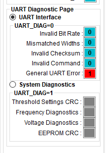

  • Hi Akeem,
    Do you have any feedback on this?
    I also noticed that testing with the demoboard (BOOSTXL-PGA460) for both UART and OWI communication, the bit that refers to "General UART Error" is always active.
  • Hi Jonatan,
    The fact that the EVM-GUI combination is reporting a general UART error is concerning, as I have not encountered this error on the TI hardware. As described in Table 4 "UART Diagnostic Data Description" of the datasheet, a General communication error can occur when:

  • Hi Jonatan,
    I've made a recent realization that when the IO_IF_SEL bit is '1' for One-Wire UART mode, the General UART Error bit of the Diagnostic Field is high. Do you have the bit IO_IF_SEL=1 in your case? This error reporting may be an unintended bug in the device; I'll need to verify, though it does not seem to impact performance/operation.
  • Hi Akeem,
    Yes, the IO_IF_SEL bit is high in my application and also the tests I do with Demo (BOOSTXL-PGA460).
    Thanks.

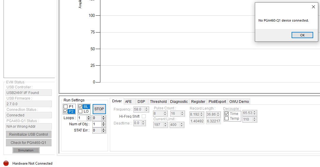

  • Hi Akeem,
    I noticed that a new version of PGA460-Q1 EVM GUI software (1.0.2.0 Rev.T) is available, but this version has a problem, because testing OWI communication with my application or DemoBoard (BOOSTXL-PGA460) a error occurs witch communication, this does not allow the driver to be configured and it is not possible to run the commands. Installing the previous version PGA460-Q1 EVM GUI (1.0.1.9 Rev.S), everything works normally.
  • Hi Jonatan,
    I am unable to replicate this error. I am still able to successfully use the OWI-mode of the PGA460-Q1 EVM GUI of version 1.0.2.0. Are you still able to use the standard mode of the latest GUI? You can also force the reprogramming of the MSP-EXP430F5529LP to ensure you have the latest version of the firmware installed, although there was no firmware updated moving from version 1.0.1.9 to 1.0.2.0.
    You can also probe the IO pin to check if the master controller is transmitting data, and check if the PGA460 is responding. If there is communication at a device level, then it is likely GUI related, which I will need to further investigate.
