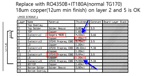

We would like to make sample PCB using IWR6843 based PCB design.
Even with this production, will it be fine?

Can you please provide some more details. It's unclear what you are asking?

A: Original design:370HR , B: our suggestion: IT180A
A:Original design:L2 and L5 copper:1.2mil, B: our suggestion:L2 and L5 copper:0.47mil
Is this feasible solution?
or it must not work fine?
http://121db.wapeul.com/IT-180A-Data-sheet-rev-1.0-19-20190328.pdf
If you change the layout properties and dimensions of traces, you need to ensure the impedance of the CPWG is maintained.
