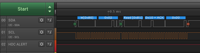

  • Hi Josh,
    I attach the waveform here..
    I am using slave address 0x42.
    As can be seen, after sending address 0x00, the DRDYn pin (the blue waveform) is still high.
    regards,
    Nelson
  • Nelson -
    Can you check that you are respecting the tLOW time after start condition? (should be 1.3uSec or greater) - this would be measured from SCL at GND to base of first rise of next clock cycle - looks like you are at 20uSec per division, i looked at clock frequency based on that, looks like you are running 100kHz, so that is what led me to ask this question as it looks like it might be too short, what you have there. Also, this would shift everything over like its supposed to be - if you increase that time, as the ACKs here are questionable. They are not strong and they don't line up well with clock and i see an extra blip there in the middle, right after the ninth clock.
    Did you also send the SOFT_RESET before this?
    Can you try weaker pull up resistors?
    Do you have the bypass capacitor installed?
