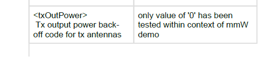

hello
as above mmwave sdk userguide described, txOutPower setting is in the profileCfg
it said only value 0 has been tested, if I want to reduce the txOutPower, how do I setting this field?

Hi KuangMing,
Please see this previous post for help on Tx power backoffs.
https://e2e.ti.com/support/sensors/f/1023/t/633604
