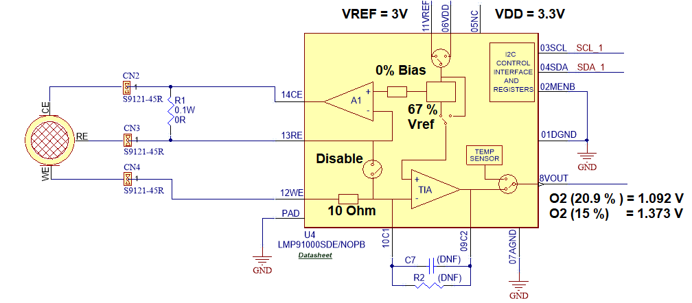

Dear TI Experts,
 I would like to get your advice for performance of LMP91000SDE/NOPB chip. I am trying to improve Analog Output, Vout reading using Alphasense O2-A3 Oxygen Sensor. At this point of time, I am getting Vout reading of 1.092V for 20.9 % of Oxygen and 1.373 V for 15 %.
 I just want to know whether I can get better sensitivity for analogue output, Vout without changing Vref or VDD. I am expecting to get more Vout voltage differences for Oxygen level changes.  I have tried different TIA gain setting but it didn’t improve. Below is schematics and POTENTIOSTAT Setting.
