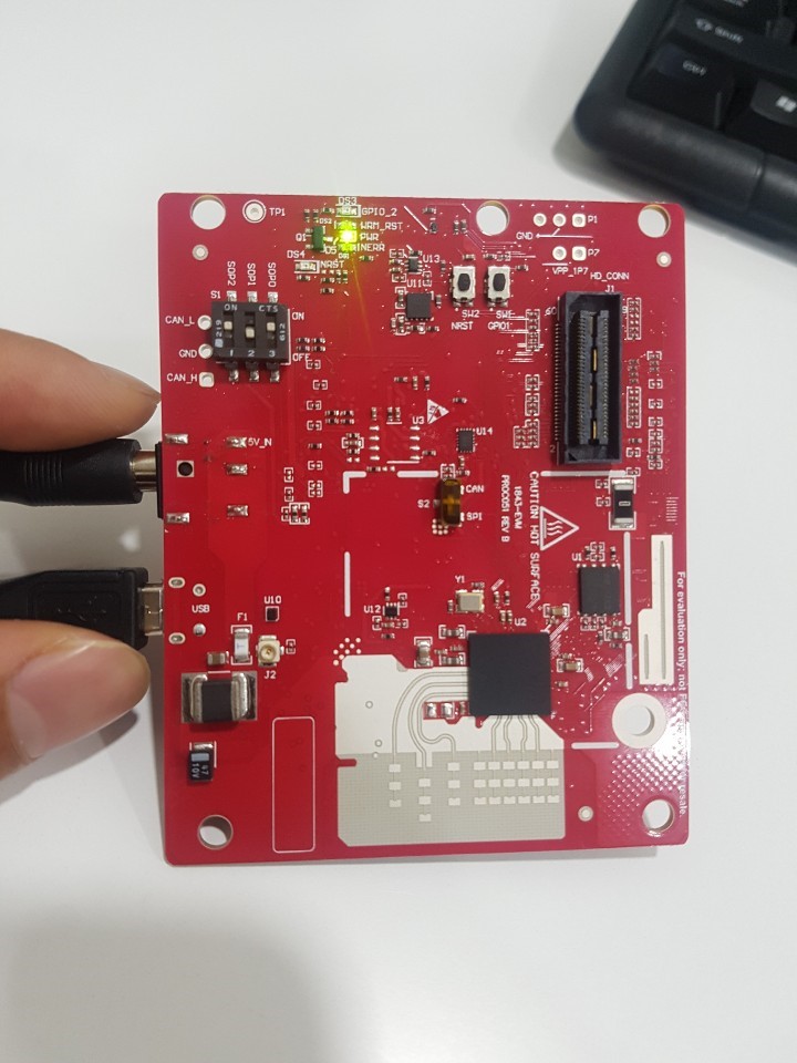

Based on awr1843boost gerber file, we changed the awr1843 chip to iwr6843 to make an EVM sample board.

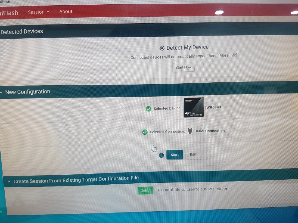

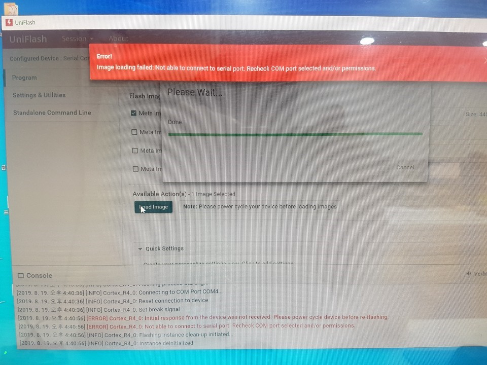

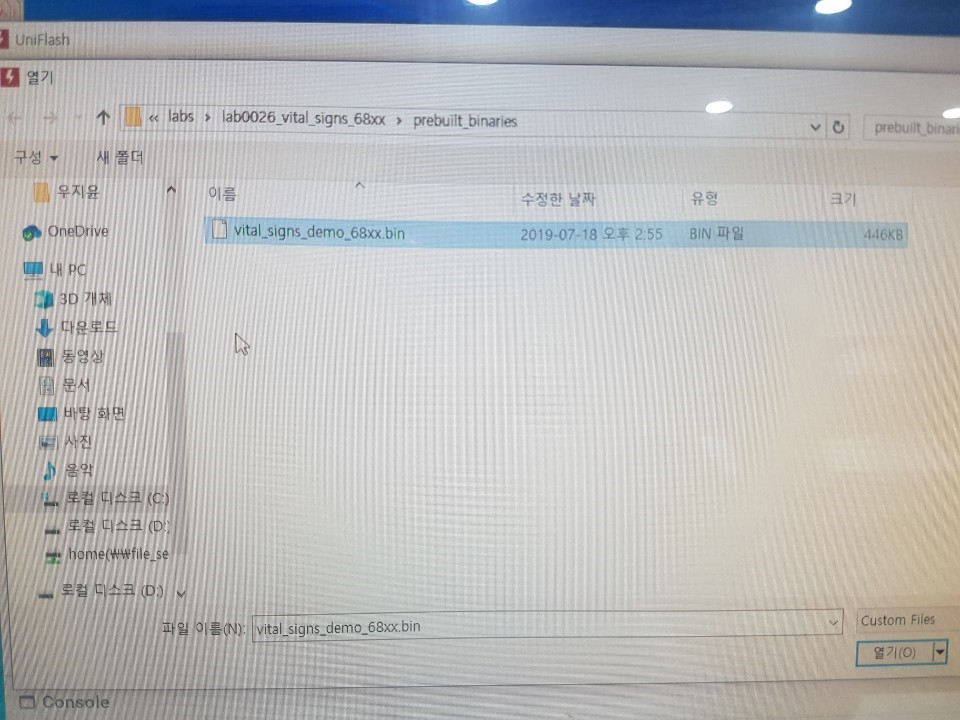

The xds110 firmware download was successful, but I couldn't insert vitalsigndemo.bin using uniflash. I want to know how to set sop0 ~ 2 and how to put vitalsigndemo.bin

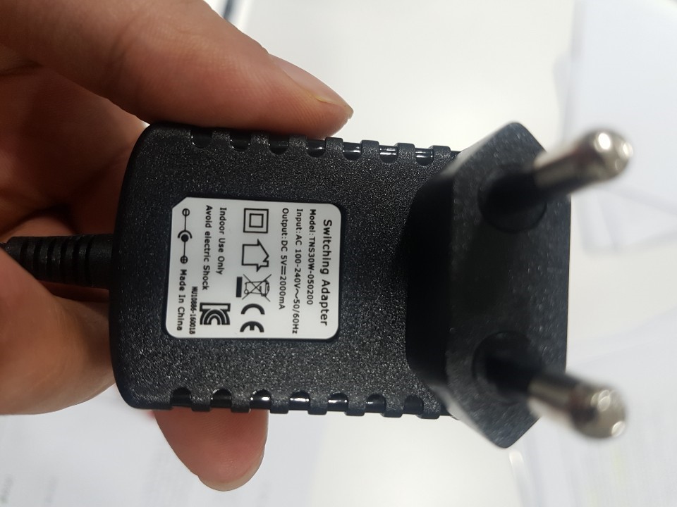

The specification and sop setting for power line are as follows.
Please make sure you go to the "Settings & Utilities" tab and change the COM port number to the number that says "Application/UART" in Windows Device Manager.
Please also make sure that your power supply is 5V and at least 2.5A.
