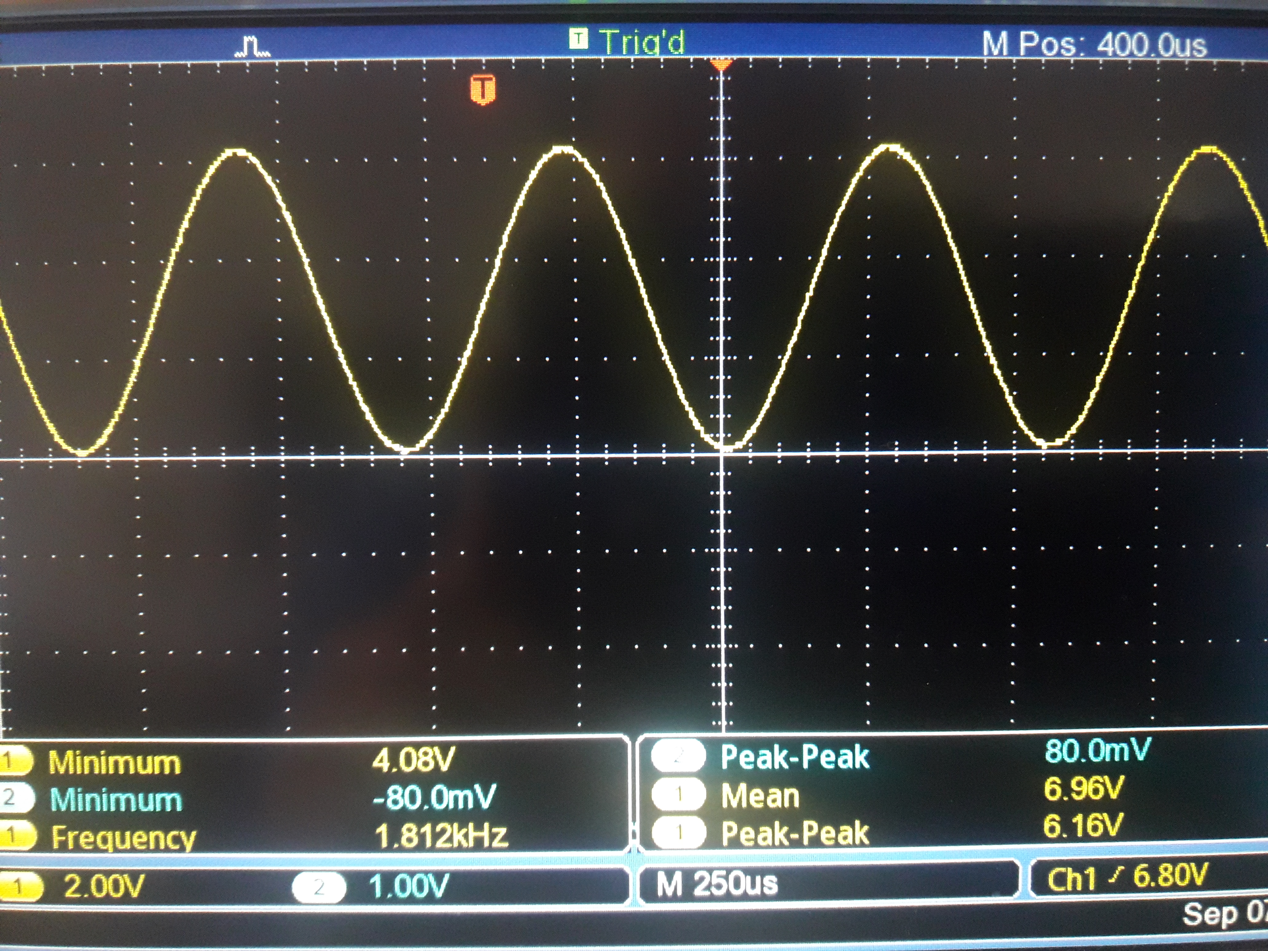

I am using PGA970EVM with usb2any. I have issue of sine wave frequency. I set 5KHz  in WFM Frequency. Then I populate waveform table and click on write. Then clicked on Generate then I am getting 1.812KHz frequency.
I checked at PI(TP16). There also 1.812KHz. What is going wrong.

  • Hello Scott,
    Currently nothing is given to the output. But this problem arise only after I connected HB LVDT probe(T101F peterhirt make). But after disconnecting load then also this problem remained same.
    I have attached wavefrom coming on DSO, waveform table and waveform output settings.

  • Hi Somnath,
    It does appear that everything is set up correctly. There have been similar reports like you mentioned that may be due to a defective PGA970 device. Where did you purchase the EVM? If you return the EVM through the store that you purchased it then you should be able to get a replacement. What is the top-marking on the PGA970 device that is soldered to your EVM?

  • Hello Scott,
    Any news related to waveform generation issue.
    I replaced new PGA970 IC in EVM board then it start working fine. Waveform coming as per setting.
    I interfaced HBT probe to PGA1(S1P and S1N) using external inverting and noninverting amplifier with unity gain. It worked fine(I observed it for 2 days). Then same I connected another HBT probe at PGA2(S2P and S2N). Again Waveform generation problem start. Before connecting to pga2, I checked all signals like primary excitation and differential output from external opamp. All signals were fine. Now it is giving 3.9KHz for setting of 5KHz. What may be issue?
    How much the maximum voltage is okay at S1P and S2P? Because my inverting and non inverting signals were 2V pk-pk but riding on 7.5V dc.

  • Hi Somnath,
    Just to clarify, after connecting the waveform output to the S2N and S2P the waveform generation stopped supplying the correct frequency, and it never returned to the correct frequency, even if the second HBT probe was removed?
    You are most likely running into an issue with the voltage levels at the S1 and S2 gain inputs. The input voltage maximum at each pin is specified at 2V (6.12 Electrical Characteristics – S1 and S2 Gain).
  • Hi Scott,
    Yes. It never comes to correct frequency even if I removed all probe connections.
    Okay. I will take care of it.
