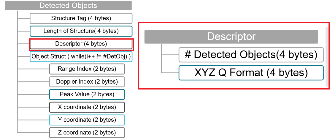

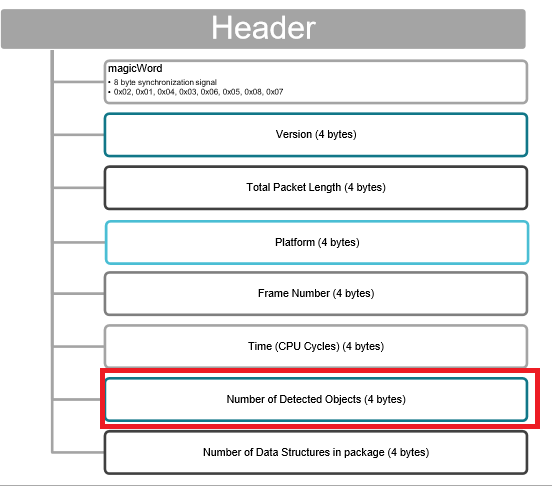

AWR1843BOOST: AWR1843 parsing problems and confusing parsing manual.
Part Number: AWR1843BOOST
Hello, I would like to know how to interpret this because it shows that descriptor is 4 bytes and than inside descriptor there is two four byte data points. And for the second picture what is the diffrence between #detected objects inside detected objects structure and number of detected objects inside the header.
