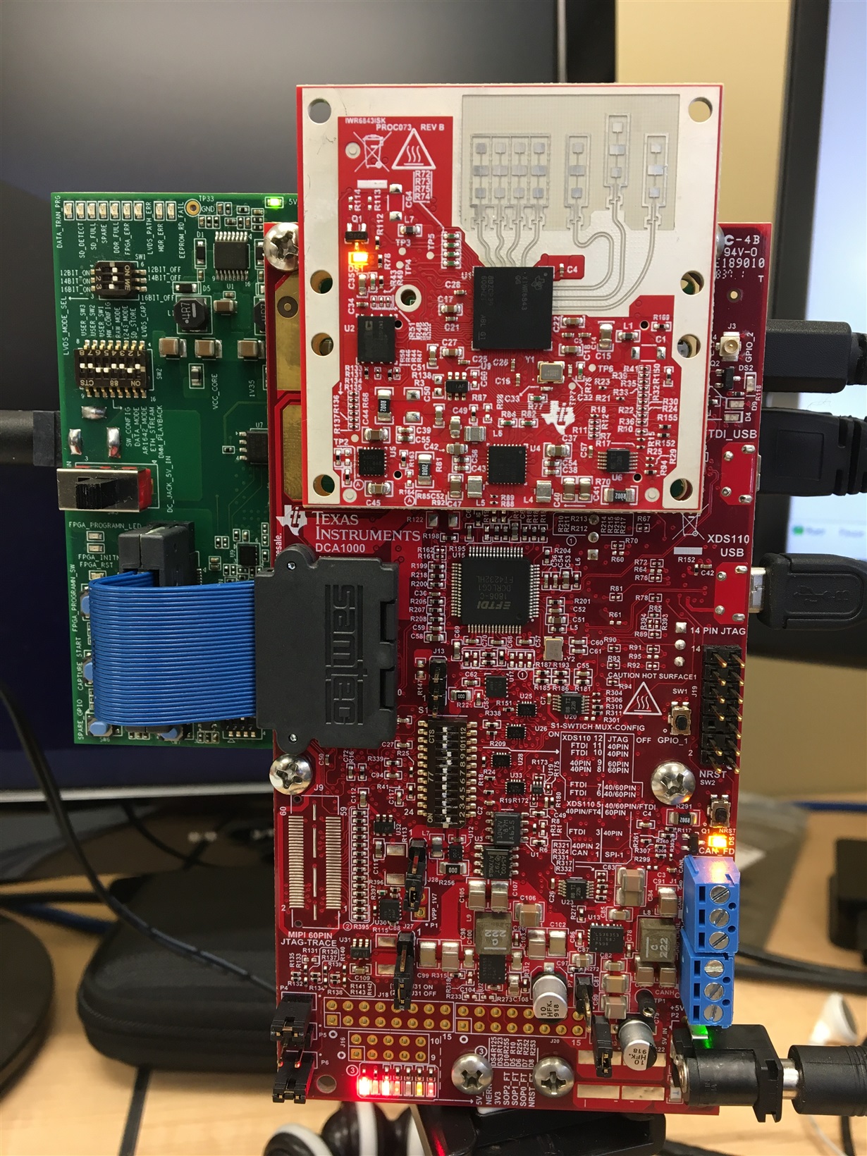

So. I am trying to get mmwave Studio 2.0.0.2 connecting to a IWR6843ISK/MMWAVEICEBOOST/DCA1000 combo. I want to dump raw radar data using the DCA1000.
Previously I was unable to connect to the IWR6843ISK using the mmwave demo visualizer, as I was using ES1.0 firmware. Noting this I am now using the mmwave Studio version 2.0.0.2 which remarks it has IWR6843 ES1.0 IWR6843 Evaluation Module (IWR6843ISK + MMWAVEICBOOST) Note: Can only be used with DCA1000 EVM. So I believe I'm using the correct version of the software.
support.

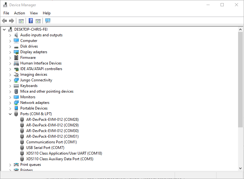

I am receiving when attempting to connect to the RS232 option in mmwave Studio. I am selecting the corresponding COM for the XDS110 Class Application/User UART.
[13:18:12]  [RadarAPI]: ar1.Connect(18,115200,1000)
[13:18:14]  [RadarAPI]: Error: Connection failed: Calling_ConnectTarget returned 3
[13:18:14]  [RadarAPI]: ar1.Calling_IsConnected()
[13:18:14]  [RadarAPI]: ar1.SaveSettings('C:\Users\Chris\AppData\Roaming\RSTD\ar1gui.ini')
when attempting to connect to the device.
The pictures show SOP2 jumped, but I have tried it unjumped as well without luck.
