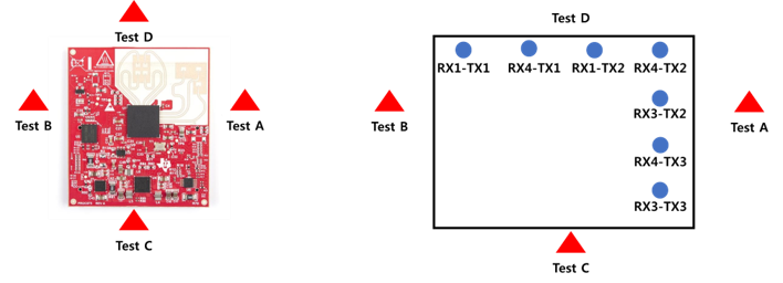

I’ve tried 4 experiments (testA ~ testD). In each experiment, the moving toy train was placed either below/above/left/right side of the sensor as specified below figure.
The right figure shows the virtual antennas and the position of trains.

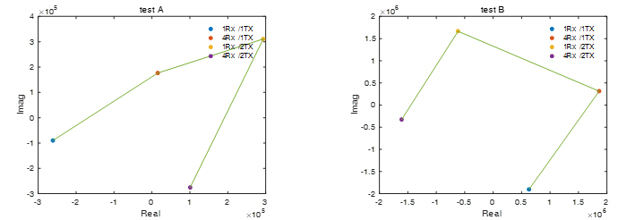

From 1TX-1RX data, I made range-velocity map and estimated the range and velocity of the object using a peak detector.
And then plotted the phase change across the antennas.
The result of Test A, and Test B is correct.

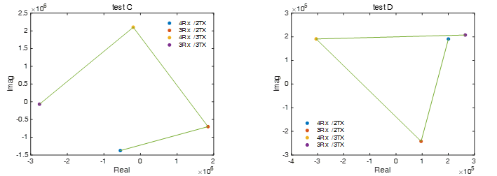

When the object is at TestA location, the phase along RX1-TX1, RX4-TX1,… RX4-TX2 decreases as below figure.
And it increases when the object is at Test B location.
However, the result is reversed for elevation antennas.
From what I understand, when the object is above the sensor (testD), phase along RX4-TX2, RX3-TX2, RX4-TX3, RX3-TX3 must increase. However, it is decreased.
Also, when it is located below the sensor the phase is increased.
