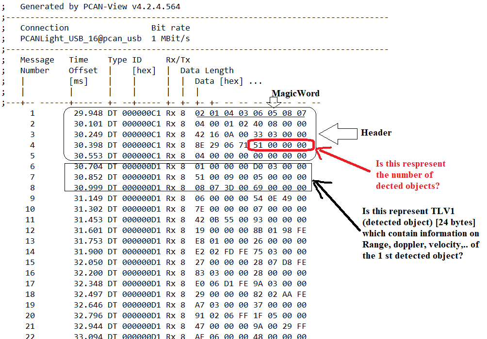

Dear all,
Thank you for your support and answering to my related questions ( https://e2e.ti.com/support/sensors/f/1023/t/840424 ) .
That issue is resolved now after some modifications in object detection over can lab MSS main. Consequently, I started receiving correctly and continuously both CAN FD and CAN classic frames from the AWR1642BOOST revB.
To communicate with an ECU (this ECU Supports only CAN 2.0 with 500 Kbits/s), I need CAN Technical Description for the AWR1642 Evaluation Module (AWR1642BOOST) or DBC file.
Could you please provide me the technical description for the AWR1642 Evaluation Module (AWR1642BOOST) or DBC file? or just tell me how to generate dbc file!
