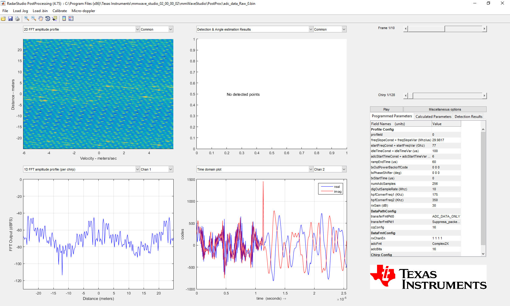

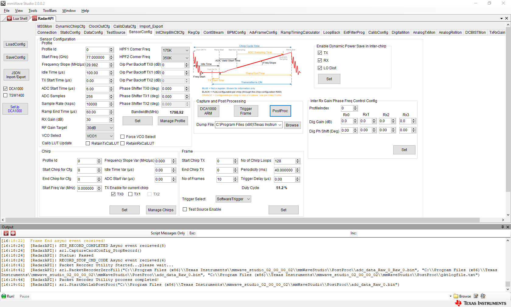

I am trying to get raw data from the AWR1642BOOST using the DCA1000EVM but it seems to be something wrong with the collected data. I have made a similar setup using TSW1400 before and got the correct data but not this time. Could you assist me on this matter? I attach the plots and log files.

[15:53:32]  [RadarAPI]: ar1.ChanNAdcConfig(1, 1, 0, 1, 1, 1, 1, 2, 2, 0)
[15:53:32]  [RadarAPI]: Status: Passed
[15:53:35]  [RadarAPI]: ar1.LPModConfig(0, 1)
[15:53:35]  [RadarAPI]: Status: Passed
[15:53:37]  [RadarAPI]: ar1.RfInit()
[15:53:37]  RF Init async event received!
[15:53:37]  [RadarAPI]: Status: Passed
[15:53:37]  [RadarAPI]: Time stamp, Temperture: 51278,29; APLL Status, Update: 1, 0; SynthVCO1 Status, Update: 1, 1; SynthVCO2 Status, Update: 1, 1; LODist Status, Update: 1, 1; RxADCDC Status, Update: 1, 1; HPFcutoff Status, Update: 1, 1; LPFcutoff Status, Update: 1, 1; PeakDetector Status, Update: 1, 1; TxPower Status, Update: 1, 1; RxGain Status, Update: 1, 1; TxPhase Status, Update: 0, 0; RxIQMM Status, Update: 1, 1;
[15:53:38]  [RadarAPI]: ar1.SetCalMonFreqLimitConfig(77,81)
[15:53:38]  [RadarAPI]: Status: Passed
[15:53:44]  [RadarAPI]: ar1.DataPathConfig(513, 1216644097, 0)
[15:53:44]  [RadarAPI]: Status: Passed
[15:53:45]  [RadarAPI]: ar1.LvdsClkConfig(1, 1)
[15:53:45]  [RadarAPI]: Status: Passed
[15:53:47]  [RadarAPI]: ar1.LVDSLaneConfig(0, 1, 1, 0, 0, 1, 0, 0)
[15:53:47]  [RadarAPI]: Status: Passed
[15:53:57]  [RadarAPI]: ar1.ProfileConfig(0, 77, 100, 6, 60, 0, 0, 0, 0, 0, 0, 29.982, 0, 256, 6250, 0, 0, 30)
[15:53:57]  [RadarAPI]: Status: Passed
[15:54:00]  [RadarAPI]: ar1.ChirpConfig(0, 0, 0, 0, 0, 0, 0, 1, 0, 0)
[15:54:00]  [RadarAPI]: Status: Passed
[15:54:05]  Test Source Already Disabled...!!!
[15:54:05]  [RadarAPI]: Status: Passed
[15:54:05]  [RadarAPI]: ar1.FrameConfig(0, 0, 10, 128, 40, 0, 1)
[15:54:08]  [RadarAPI]: ar1.SelectCaptureDevice("DCA1000")
[15:54:08]  [RadarAPI]: passed
[15:54:10]  [RadarAPI]: StatusDCCard Event Registered
[15:54:10]  [RadarAPI]: Status: Passed
[15:54:10]  [RadarAPI]: ar1.CaptureCardConfig_EthInit("192.168.33.30", "192.168.33.180", "12:34:56:78:90:12", 4096, 4098)
[15:54:11]  [RadarAPI]: SYSTEM_CONNECT_CMD_CODE Async event recieved(9)
[15:54:11]  [RadarAPI]: ConnectRFDCCard Status: Passed
[15:54:11]  [RadarAPI]: ReadRFDCCarFpgaVersion Status: Passed
[15:54:11]  [RadarAPI]: READ_FPGA_VERSION_CMD_CODE event recieved(14)
[15:54:11]  [RadarAPI]: ar1.CaptureCardConfig_Mode(1, 2, 1, 2, 3, 30)
[15:54:11]  [RadarAPI]: Status: Passed
[15:54:11]  [RadarAPI]: CONFIG_FPGA_GEN_CMD_CODE Async event recieved(3)
[15:54:11]  [RadarAPI]: ar1.CaptureCardConfig_PacketDelay(25)
[15:54:11]  [RadarAPI]: CONFIG_PACKET_DATA_CMD_CODE Async event recieved(11)
[15:54:25]  [RadarAPI]: ar1.CaptureCardConfig_StartRecord("C:\\Program Files (x86)\\Texas Instruments\\mmwave_studio_02_00_00_02\\mmWaveStudio\\PostProc\\adc_data.bin", 1)

[15:55:53]  [RadarAPI]: Packet Reorder Utility Started...please wait...
[15:55:53]  [RadarAPI]: ar1.PacketReorderZeroFill("C:\\Program Files (x86)\\Texas Instruments\\mmwave_studio_02_00_00_02\\mmWaveStudio\\PostProc\\adc_data_Raw_0.bin", "C:\\Program Files (x86)\\Texas Instruments\\mmwave_studio_02_00_00_02\\mmWaveStudio\\PostProc\\adc_data.bin", "C:\\Program Files (x86)\\Texas Instruments\\mmwave_studio_02_00_00_02\\mmWaveStudio\\PostProc\\pktlogfile.txt")
[15:55:58]  [RadarAPI]: Packet Reorder Utility process completed!
[15:56:13]  [RadarAPI]: ar1.StartMatlabPostProc("C:\\Program Files (x86)\\Texas Instruments\\mmwave_studio_02_00_00_02\\mmWaveStudio\\PostProc\\adc_data.bin")
[15:56:13]  [RadarAPI]: Error:
[15:56:13]
[15:56:13]  ... MWMCR::EvaluateFunction error ...
[15:56:13]  31-Oct-2019 15:56:13: The file C:\Program Files (x86)\Texas Instruments\mmwave_studio_02_00_00_02\mmWaveStudio\PostProc\adc_data.bin is empty. Please capture more data.,1,
[15:56:13]  Error in => process_adc_data.m at line 52.
[15:56:13]
[15:56:13]  ... Matlab M-code Stack Trace ...
[15:56:13]      at
[15:56:13]  file C:\Users\mml\AppData\Local\Temp\mml\mcrCache8.5.1\Matlab1\Logging\log_status.m, name log_status, line 32.
[15:56:13]      at
[15:56:13]  file C:\Users\mml\AppData\Local\Temp\mml\mcrCache8.5.1\Matlab1\Processing_functions\read_adc_data.m, name read_adc_data, line 28.
[15:56:13]      at
[15:56:13]  file C:\Users\mml\AppData\Local\Temp\mml\mcrCache8.5.1\Matlab1\MatlabPostPr\process_adc_data.m, name process_adc_data, line 52.
[15:56:13]
[15:56:13]
[15:56:13]  Trace:
[15:56:13]     at MathWorks.MATLAB.NET.Utility.MWMCR.EvaluateFunction(String functionName, Int32 numArgsOut, Int32 numArgsIn, MWArray[] argsIn)
[15:56:13]     at MathWorks.MATLAB.NET.Utility.MWMCR.EvaluateFunction(Int32 numArgsOut, String functionName, MWArray[] argsIn)
[15:56:13]     at MatlabPostProcGui.MatlabPostProcGUIClass.process_adc_data(MWArray adc_file_name, MWArray force_cont_stream_mode)
[15:56:13]     at AR1xController.frmAR1Main.iStartCaptureMtlabPostProc()
[15:57:08]  [RadarAPI]: Packet Reorder Utility Started...please wait...
[15:57:08]  [RadarAPI]: ar1.PacketReorderZeroFill("C:\\Program Files (x86)\\Texas Instruments\\mmwave_studio_02_00_00_02\\mmWaveStudio\\PostProc\\adc_data_Raw_0.bin", "C:\\Program Files (x86)\\Texas Instruments\\mmwave_studio_02_00_00_02\\mmWaveStudio\\PostProc\\adc_data.bin", "C:\\Program Files (x86)\\Texas Instruments\\mmwave_studio_02_00_00_02\\mmWaveStudio\\PostProc\\pktlogfile.txt")
[15:57:13]  [RadarAPI]: Packet Reorder Utility process completed!
[15:57:28]  [RadarAPI]: ar1.StartMatlabPostProc("C:\\Program Files (x86)\\Texas Instruments\\mmwave_studio_02_00_00_02\\mmWaveStudio\\PostProc\\adc_data.bin")
[16:08:21]  [RadarAPI]: Packet Reorder Utility Started...please wait...
[16:08:21]  [RadarAPI]: ar1.PacketReorderZeroFill("C:\\Program Files (x86)\\Texas Instruments\\mmwave_studio_02_00_00_02\\mmWaveStudio\\PostProc\\adc_data_Raw_0_Raw_0.bin", "C:\\Program Files (x86)\\Texas Instruments\\mmwave_studio_02_00_00_02\\mmWaveStudio\\PostProc\\adc_data_Raw_0.bin", "C:\\Program Files (x86)\\Texas Instruments\\mmwave_studio_02_00_00_02\\mmWaveStudio\\PostProc\\pktlogfile.txt")
[16:08:26]  [RadarAPI]: Packet Reorder Utility process completed!
[16:08:41]  [RadarAPI]: ar1.StartMatlabPostProc("C:\\Program Files (x86)\\Texas Instruments\\mmwave_studio_02_00_00_02\\mmWaveStudio\\PostProc\\adc_data_Raw_0.bin")
