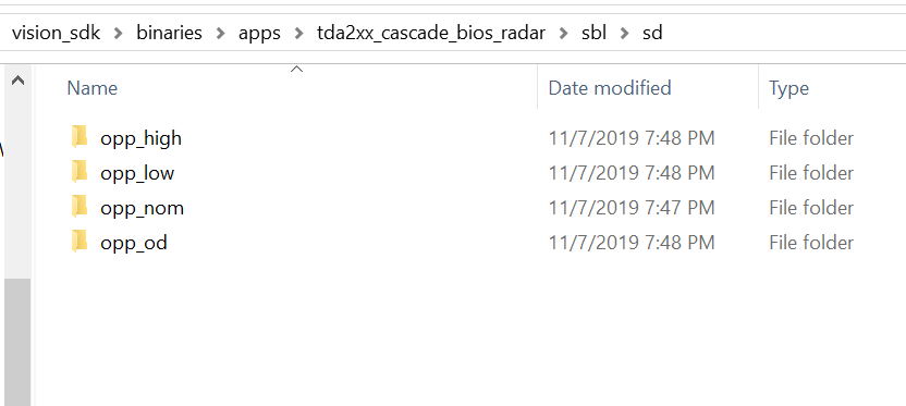

I downloaded the RADAR-SDK and I'm going through the Processor SDKRADAR user guide. At step 3.7 it said to refer section 3.5 of the Boot from SD card option on TDA2xx user guide.
It asks to make MLO from the command "gmake -s sbl". The path it says doesn't have the MLO, instead have these 4 folders as shown. You can see the path on top of that photo. The user guide didn't describe which folder to pick . Also, when I'm generating appimage by the command "gmake -s appimage", the app image is generating in  PROCESSOR_SDK_RADAR_03_07_00_00\vision_sdk\binaries\apps\tda2xx_cascade_bios_radar\vision_sdk\bin\tda2xx-evm\sbl_boot\
When I pick MLO from one of the 4 folders and paste it in my SD card along with the appimage from the above address and turn on my radar, I can't see any logs on the UART window.
Please let me know if I'm doing anything wrong or If I have missed a step which I shouldn't have. Thank you.

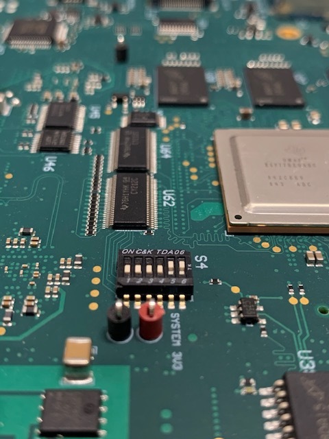

  • Hi Asher

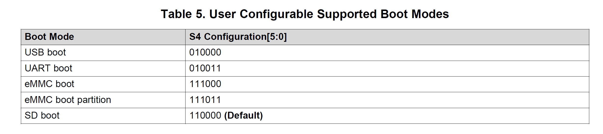

    Are you setting the boot pins correctly in the board for booting for SD card? There are dip switches on the board to set up the boot mode.
    Boot modes are defined in Section 29.2.4.4 Booting Device Order Selection of the TDA2x TRM.
    Thanks and Regards
    Piyali
  • Hi Piyali,
    I think I am, and I can verify that the DIP switches are at the right position. I do this by following mmwave_studio_cascade_userguide, I'm able to do step 5 correctly.

    I tried to boot with your binary on my setup and it boots up successfully.
    Please chec y our dip switch settings.
    Mine is 111001.

    Anuj
  • Hello Anuj,
    Did you verify on MMWCAS-RF-EVM mounted on MMWCAS-DSP-EVM?
    If I'm verifying the switch location according to the user guide "MMWCAS_DSP_EVM_USER_GUIDE"(SPRUIS6-September 2019), on page 18 it says to have the switches on these position as shown below.
    Regardless I'll try the switch position that you suggested and will get back to you with an update.
    EDIT: UPDATE: I set the position of the switch as suggested and it still didn't boot up. I don't see it on tera term
    Yes my RF board is connected and setup is same as yours.
    Please check your setup once and try to change your power supply.
    Set the dip switch as 111001.
    Anuj
  •  Asher,
    Have you tried booting with just the MMWCAS-DSP-EVM only to see if there is any boot functionality? That can show us if there is a problem with the DSP EVM or with the connection to the RF EVM.
    I know Anuj is recommending another DIP setting, but refer above for how the user guide is recommending.
    Alec
  • Hi Anuj,
    I edited my previous post(before you replied) to update that I followed your recommendation and I still didn't get anything on Tera term. Regardless, I changed my power supply, set the DIP switches to 111001 and tried booting MMWCAS-DSP-EVM with and without MMWCAS-RF-EVM and I still got nothing.
  • Hi Alec,
    When I started with this project, I was using the DIP switch position as suggested by you (110000). I didn't get anything then. Regardless, I tried booting up MMWCAS-DSP-EVM with and without MMWCAS-RF-EVM and I still didn't see anything. However, I'd like to add that if I follow the user guide of Cascade radar i.e., mmWave studio Cascade Users Guide, I can boot up and see my device spitting up logs and such on the terminal. When I try to follow the user guide of RADAR SDK i.e., PROCESSOR SDK RADAR user guide, I'm not able to boot up after I copy MLO and AppImage to my SD card with the DIP switches on the position told by guide(or you).
    EDIT: I apologize, I thought Piyali wrote this. Edited this reply to address the correct person.
