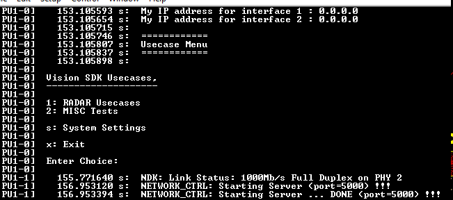

We have the AWR1243 Cascade Radar EVM with the TDA2. The VSDK is build and the SD card is booting. Now we want to run the Usecase "a: Cascade Radar (4 AWR1243) Capture + Radar Object Detect (DSP) + NetworkTx (TDA2xx Only)" with the Matlab demo. An ethernet cable is connect to our DHCP LAN. The IP address is showing 0.0.0.0. How to configure the IP address?
[IPU1-0]     3.149545 s: Current System Settings,
[IPU1-0]     3.149606 s: ========================
[IPU1-0]     3.149637 s: Display Type   : HDMI 1920x1080 @ 60fps
[IPU1-0]     3.149698 s: My IP address for interface 1 : 0.0.0.0
[IPU1-0]     3.149789 s: My IP address for interface 2 : 0.0.0.0
[IPU1-0]     3.149850 s:
[IPU1-0]     3.149881 s: ============
[IPU1-0]     3.149942 s: Usecase Menu

  • Anuj,
    The IP address is not being assigned with the MLO and AppImage you sent. Tested on both of you TDA2 EVMs. If you are talking about the RJ45 Ethernet cable, I tried remove and connect back again then check with no IP address.
    It seems to report a good link status. Is it possible the printf of ip address 0.0.0.0 is incorrect? From the Matlab demo M file I am expecting an ip address at 128.247.75.78 but pinging address this is also a fail.
    What next?
    Zach
     Zach
  • 1. Enable static ip by making enableStaticIpEth0     = 1 in NDK_config.cfg located at <path>\PROCESSOR_SDK_VISION_03_07_01_00\vision_sdk\links_fw\src\rtos\bios_app_common\tda2xx\cfg
    2. Recompile your code to generate a new AppImage to use to bootup from SD card. On bootup, 192.168.1.200 will be assigned to interface 1.
    3. Set a static ip address on the ethernet port on your remote pc as 192.168.1.x where 1<x<256 and x != 200
