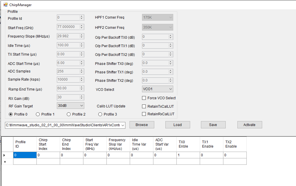

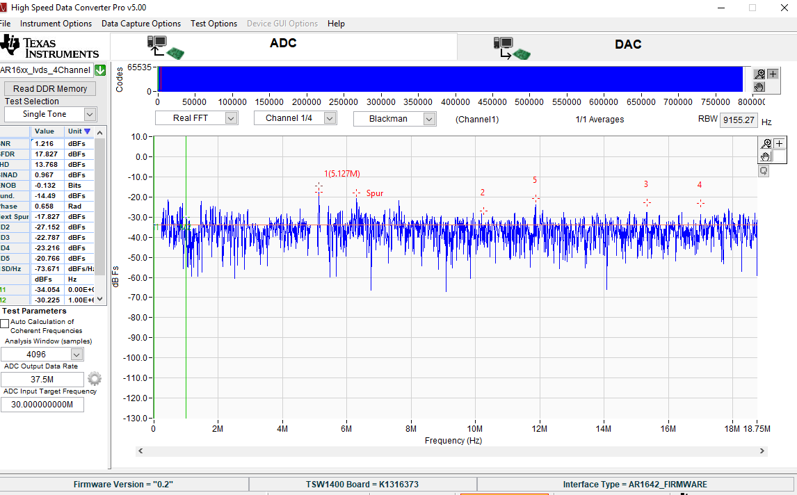

Hi i am using AWR1642 with tsw1400 , i have done and got the results in the hdsc pro , but how do i find the chirp duration and number of chirps in the mmwave studio . I have listed below the calliberation in the mmwave studio .
  • Hello Jopaul,
    The ramp end time that you configure in the profile configuration will be the duration of the chirp .
    Number of chirps in a frame are given by the frame configuration. (End chirp index - start chirp index+ 1) * number of chirp loops.
