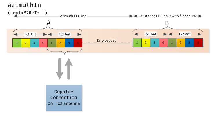

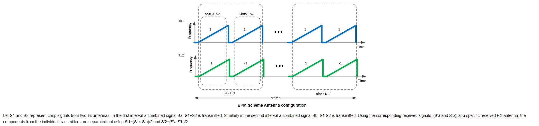

I am using BPM scheme while transmitting the waveform. I use DCA 1000 to capture the ADC data. From the documentation I have,
During data processing, As per my understanding pointer A holds S1’a, S2’a, S3’a, S4’a where S’a is the received signal for the first interval. Similarly, pointer B holds S1’b, S2’b, S3’b, S4’b where S’b is the received signal for the second interval. Is this correct? Also, is there any virtual antenna array concept applicable here?
And if some one has any Matlab script to decode the ADC samples using BPM  configuration, please do share.
