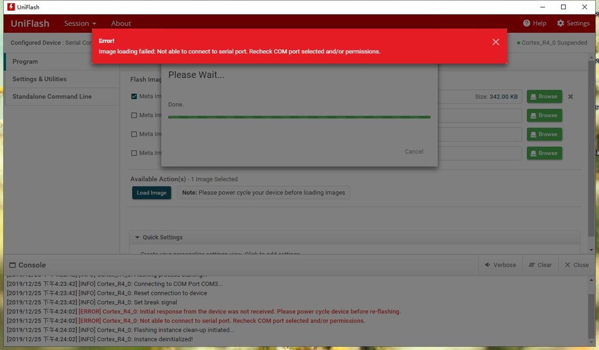

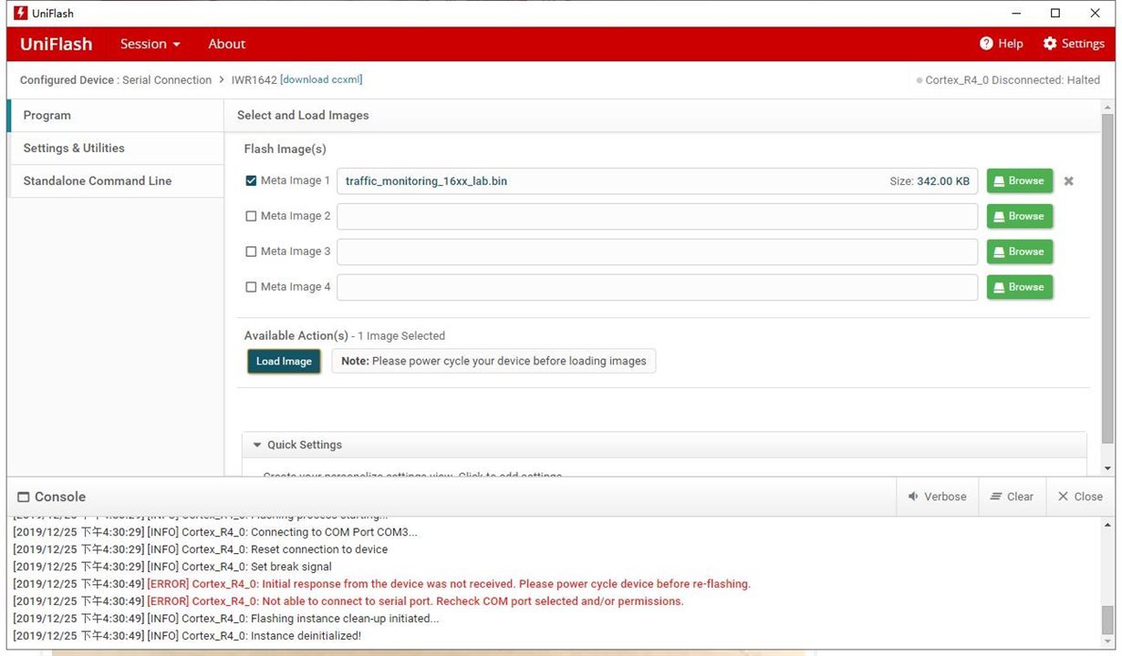

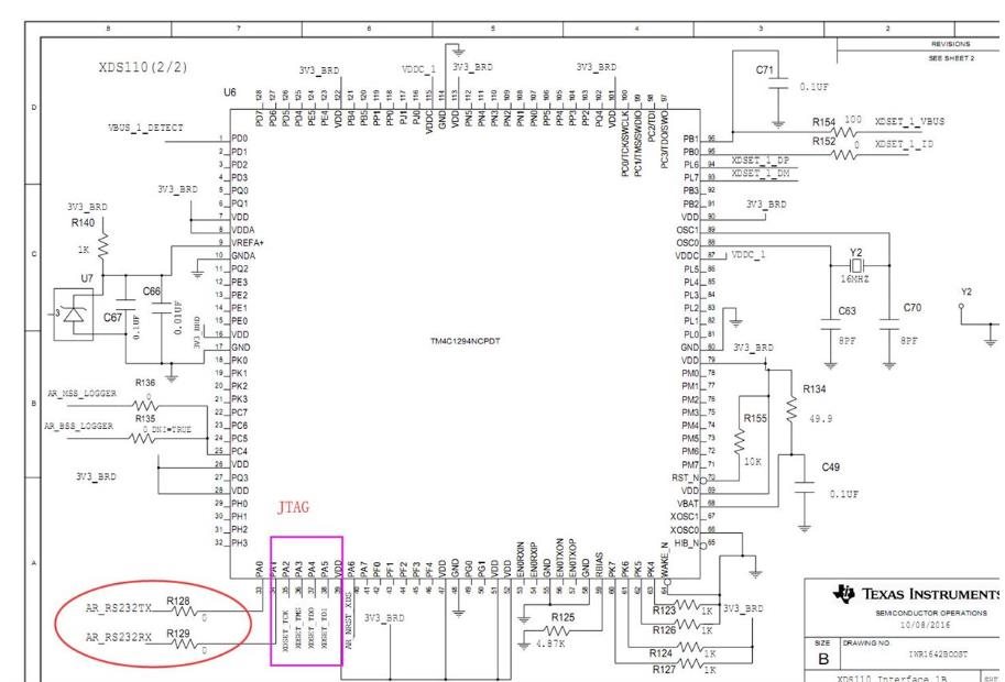

Customer used IWR1642BOOST, he wanted to communicate to PC via bluetooth, so he removed R128 and R129 resistors.
But he can't use uniflash to flashing the .bin file. Below is the error message.
