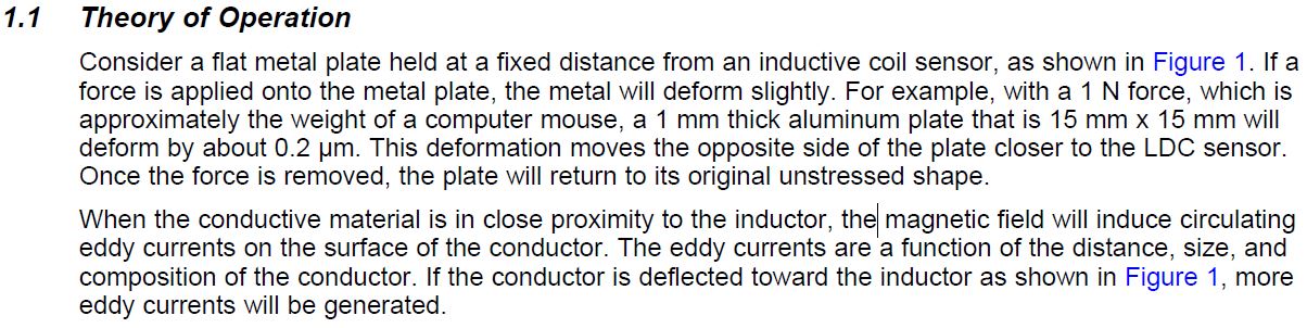

I have confused to the micro variable, please share your experience, thanks.
1. Do you know how much the copper micro variable will trigger? The spec (SONA961) mentioned that if the aluminum material is used, a 0.2um micro variable will work? Is this the minimum micro variable?

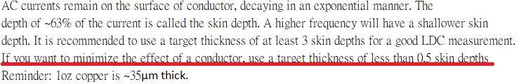

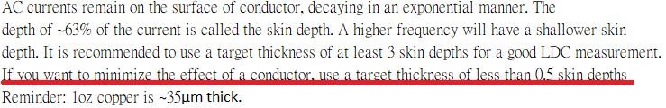

4. The following is a description of the excel calculation table, what does red line mean?
  • Hi Alex,
    1. We recommend a 0.2mm deflection. I recommend using the Metal Deflection tool in the LDC Tools excel calculator.

    4. If you had conductive material near to the coil that you did not want to affect the measurements, it could be at most 0.5 skin depths thick for the LDC to effectively ignore its presence.
