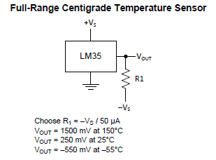

I'm asking these questions because I want to multiplex four LM35 outputs in the following way.
6. Is there any problem with doing this?

    To address the Abs Max ratings, this is more of a process definition and is indicative of the limit of the process. Think of it more as a safety precaution of our device in case of failure. Even if through proper operation of the device it would not reach these Abs Max ratings. With this in mind, I am wondering why in your schematic you have the devices outputs pulled down to -15V? Although there is a shunt resistor, this would violate our abs max min of -1V.
    In the datasheet, there is no indication that having Vout at  -5V should be an issue. Would this be the same voltage as the supply? I would need to test and verify whether there could be some back current that could power the device if Vout is sitting on a higher rail than Vsupply even when device is unpowered. Although I doubt this to be the case.
    Jalen
  • My schematic pulls down to -15V via 330K ohms as suggested by this datasheet diagram (to obtain ~50uA Vout current):
    Please note that when the device is unpowered (Vcc=0V) in this configuration, I see that Vout goes to about -500mV, which doesn't violate the -1V absolute max Vout spec.

    I understand your schematic. I don't think you should run into any issues, but I would verify that there is not back current powering the device when unpowered (Vcc = 0V). It seems like you may have tested for this though. This implementation should be fine.
