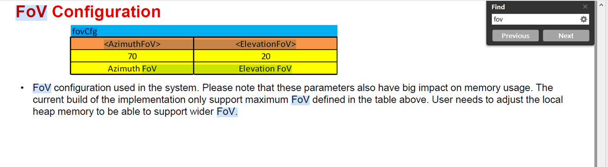

We would like to utilize the maximum FOV of IWR6843ISK-ODS for the 3D People Counting Lab. In my understanding, the Azimuth and Elevation can cover up to 120 degrees. Please correct me if I'm wrong.
However, the people counting lab is limited to 70/20 degrees only for Azimuth/Elevation as indicated in the 3DPeopleCountingDemo_ConfigurationDetails.pdf. If we would like to increase these values, may I know the steps to change it? How to change the Heap memory in the CCS project for this lab?
Also, what are the drawbacks / immediate effect in the performance of the lab in the case that we successfully increased the FOV up to maximum?
