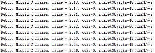

AWR1243: The network loses frames badly when using matlab to receive data
Part Number: AWR1243
I set to output only Azimuth Heatmap by the serial port, and then run radar_cascade_demo.m file with matlab. The network can transmit data, but a lot of data is lost:
In addition, when I transfer the bin file on SSD to the computer through the network, the speed is only about 4~5MB/s, is this speed normal?
Is it possible that the loss of data is caused by the slow transmission speed of the network?
thank you very much

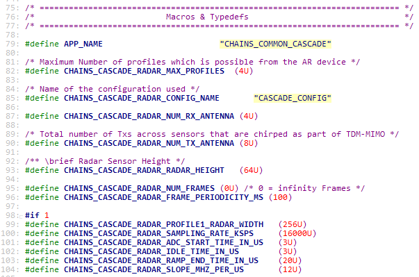

    There are the configurations I've modified:
    In fact, I don't know where to modify the parameters related to network transmission, such as frame-idle, could you please let me know where they are?
    Thanks a lot.

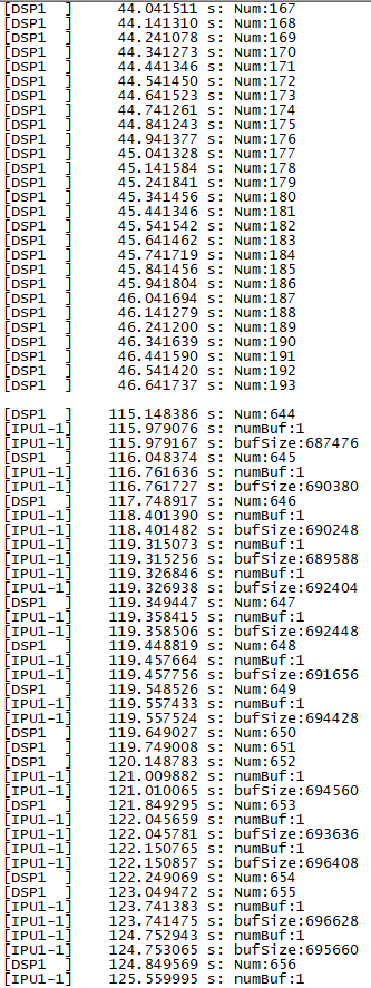

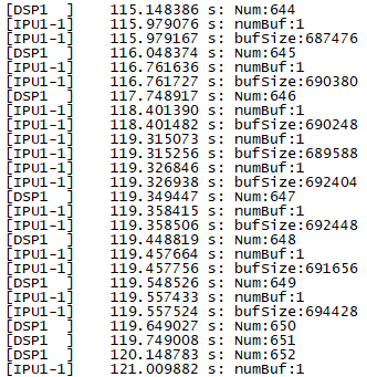

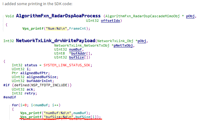

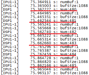

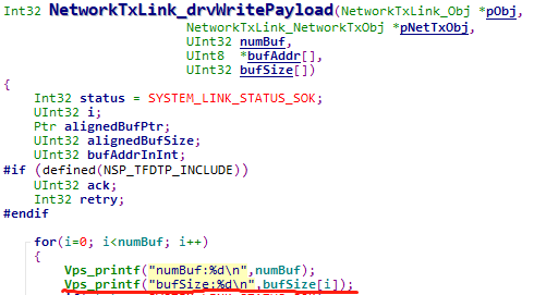

  • As you said, the speed of network connection is 1 Gbps:
    I added some printing in the SDK code:
    This is what I saw by serial port:
    The top half is the printing before running radar_cascade_demo.m, and the bottom half is the printing when running radar_cascade_demo.m.
    The frame cycle should be 100ms, but when running radar_cascade_demo.m, the network starts to transfer at this point and the frame cycle becomes very unstable.
    Could this be the reason why the network lost frames?
    Looking forward to your reply.
    Thank you very much.

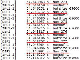

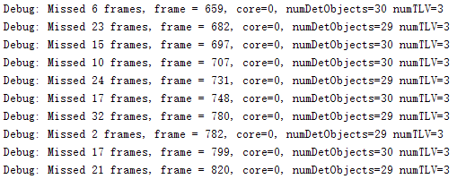

  • I tried to output only RangeProfile:
    or only noiseProfile:
    or only rangeDopHeatMap:
    In these case, the amount of data transmitted over the network is relatively small, so there is no frame loss problem.

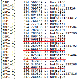

    If I only output the point cloud, the amount of data transmitted will be larger, so there will be some frame loss:
    and the frame cycle will be a little unstable:
    So it seems to be related to the amount of data being transferred over the network.

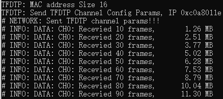

  • Here are the test results:
    Does this represent the maximum transmission speed of the network?
    If so, that seems to explain why frames are lost so badly when transmitting range-azimuth heat maps.
    JG
  • Hi JG
    The log on the windows console would only tell how many frames it finished capturing and what is the size. The test would be to keep the network_rx running and then in the target UART console to check the FPS and see if you are seeing dropped frames there.
    If no, then you know this is a matlab renderring slow down. If you still see dropped frames with network_rx, that would mean we need to see what is the network throughput requirement from the usecase and why in your setup the throughput is not recieved.
    On the TDA2x, we can eaisily achieve >600 Mbps transmit speeds with TFDTP.
    Thanks and Regards
    Piyali
  • This test proved that the network transmission rate was stable at 1.25MBps:
    When transmitting the range-azimuth heat map:
    The amount of data is about 690KB per frame, or 6.69mbps.
    Is there any other way to test the maximum transmission speed of the network?
    And as shown in the picture above, when running radar_cascade_demo.m, the network starts to transfer at this point and the frame cycle becomes very unstable,this doesn't seem normal.
    Thanks and Regards
    JG
