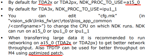

I tried to change the network from ipu1_1 to a15_0 to get better network throughput according to the manual:
Here's what I modified(C:\PROCESSOR_SDK_RADAR_03_07_00_00\vision_sdk\apps\configs\tda2xx_cascade_bios_radar\cfg.mk):
But here it says that only ipu1_0/1 is supported, which is not what the manual says.
After I changed it to a15_0, there was an error:
Does this mean that TDA2xx cannot use A15 for network transmission?
If so, how should I use the 'optimized patch' mentioned in the manual?
