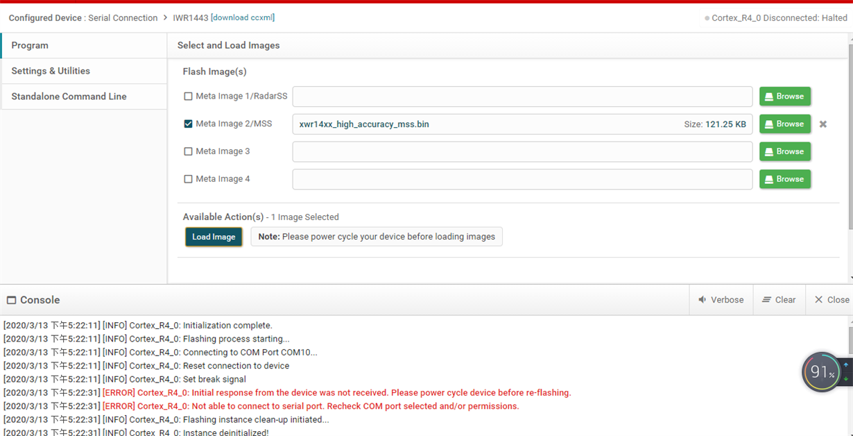

Provide all power(3.3V、1.8V、1.3V、1.192V) to IWR1443.My IWR1443 is not load code using Uniflash. Please help me to check my Schematic of IWR1443. Are there any error. Please help me to correct them.

          For connecting to Uniflash, Device need to be kept in the Flash programming boot mode and need to apply reset to register boot mode.  Then UART ports would be available for the Uniflash tool

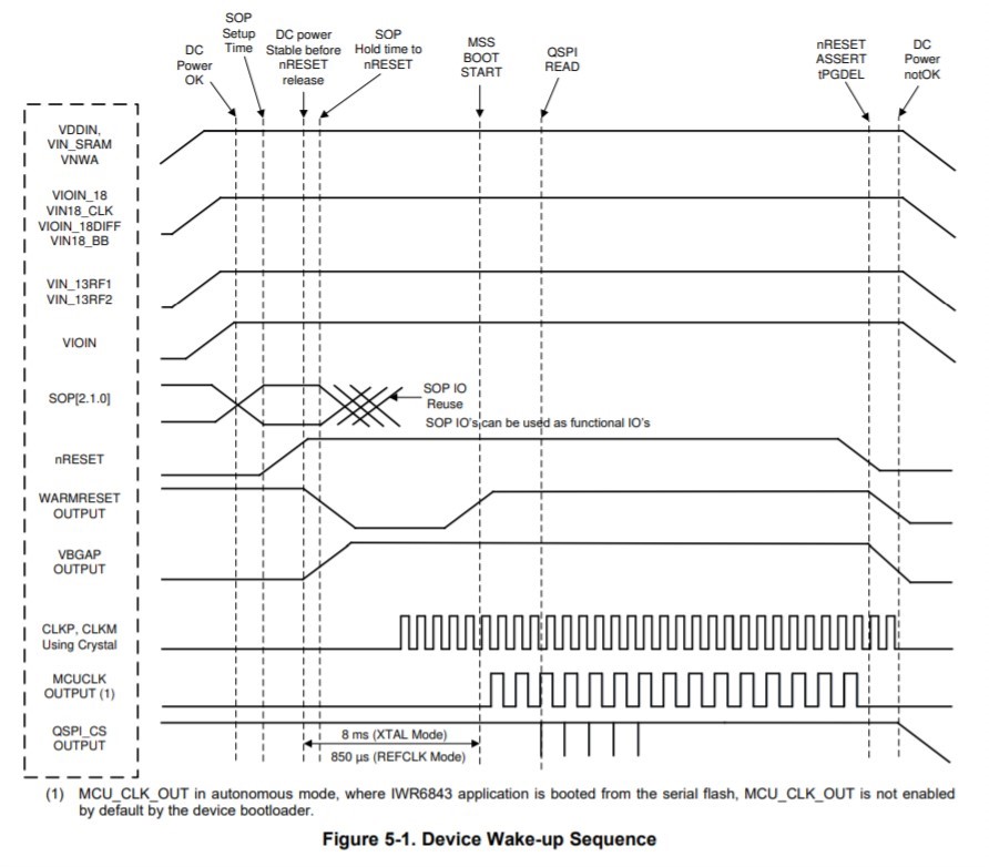

    Also you need to ensure all the power supplies are stable and SOP lines are right boot mode configuration before releasing nreset line as shown in the below diagram.
    If there is any fault in the hardware (Power supply, Clocking, Flash connectivity etc.) , NERROR pin would be asserted. Do you see this being asserted?

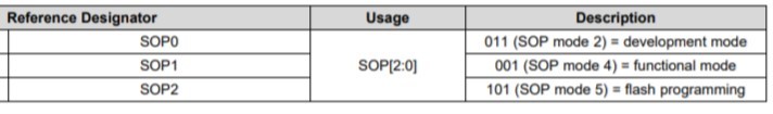

  • Set SOP0=1、SOP1=0、SOP2=1.VBGAP is 0.8V 、 VOUT_14APLL1 is 1.41V、VOUT_14SYNTH is 0V、VOUT_PA1 is 0V(No R13)、VOUT_PA2 is 0V(No R13)、NRESET is 1.6V in flash programing mode。
    IWR1443 connect to uniflash with JTAG of XDS110 DEGBUG PROBE,VBGAP is 0V 、 VOUT_14APLL1 is 0V、VOUT_14SYNTH is 0V、VOUT_PA1 is 0V(No R13)、VOUT_PA2 is 0V(No R13)、NRESET is 0.1V in flash programing mode.
    Set SOP0=1、SOP1=0、SOP2=0.VBGAP is 0.8V 、 VOUT_14APLL1 is 1.41V、VOUT_14SYNTH is 0V、VOUT_PA1 is 0V(No R13)、VOUT_PA2 is 0V(No R13)、NRESET is 3.14V in functional mode。

    Please help me to check my Schematic of IWR1443(file).In Schematic SOP0=1、SOP1=0 is fixed. If there is any fault. Please help me to correct them.

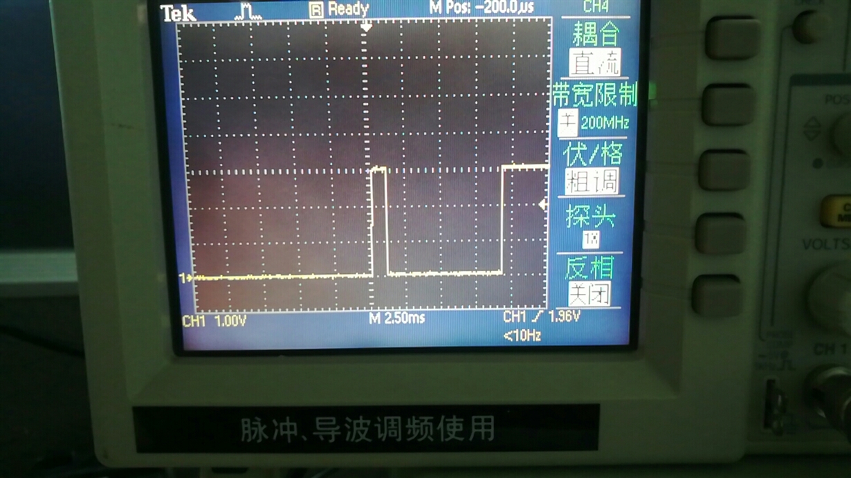

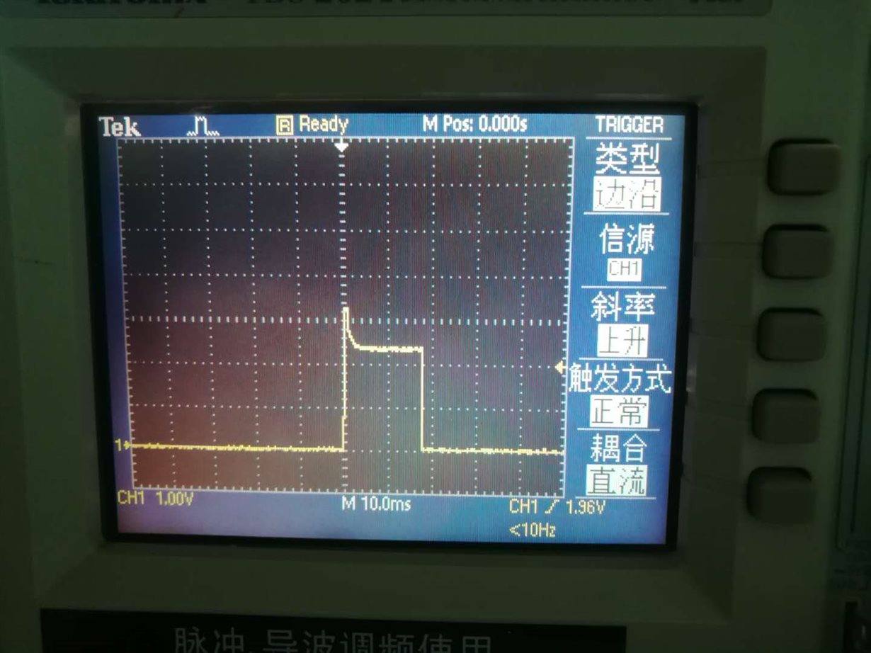

    SOP2 power up  timing sequence
    warmreset power up  timing sequence
    Thank you!!
    SOP2 pull up 3.3V, but P13 PIN(PMIC_CLK_OUT) all is 0V. Please help me.

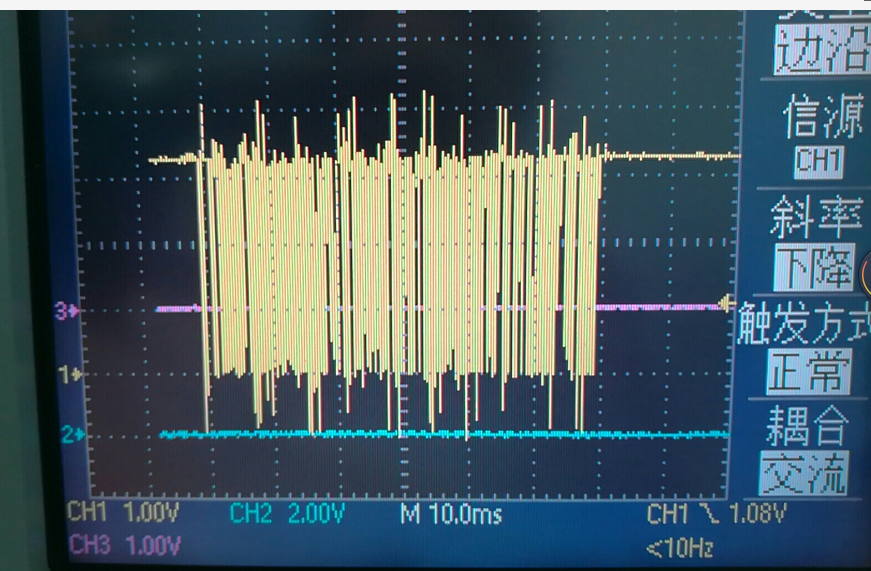

    4) After the boot mode is registered, you would notice device would start reading from the QSPI flash, And you could see QSPI_CS toggling indicating device is reading from the QSPI flash.

    In the above oscilloscope screen shot "SOP2 power up" shows going high and low why? It should be held low in functional mode.
