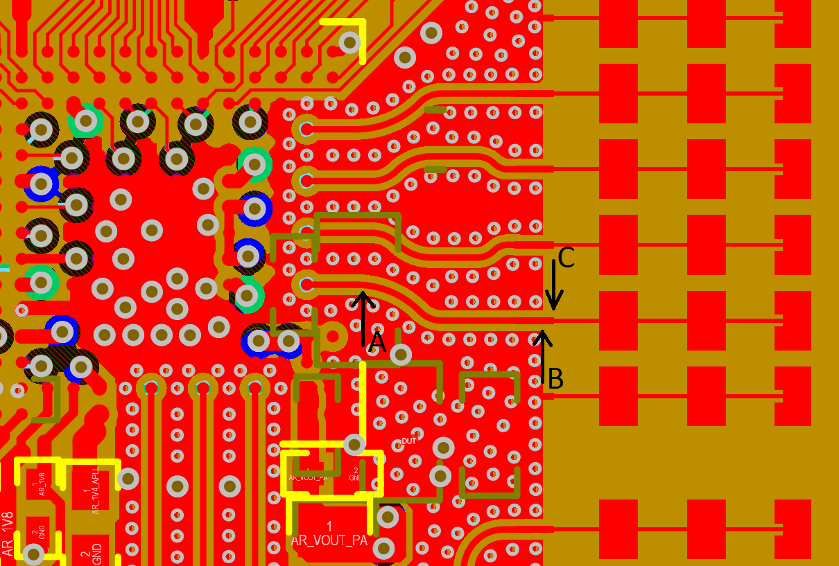

We are working on custom antenna and feed for xWR1443.
50 ohm reference is at edge of the package according spracg5.pdf.
It seems than we should use 78.5 GHz as central frequency according 2134.AWR1642_AWR1443_antennas_simulation2.pdf
Half wavelength of feed line for 78.5 GHz seems to be 1.95mm according our simulation.
AB length is 4.913mm
AC length is 5.198mm
4.913/1.95 = 2.52
5.198/1.95 = 2.67
But feed should be a multiple of half wavelength. Why do you use feed that is multiple of quarter wavelength?
