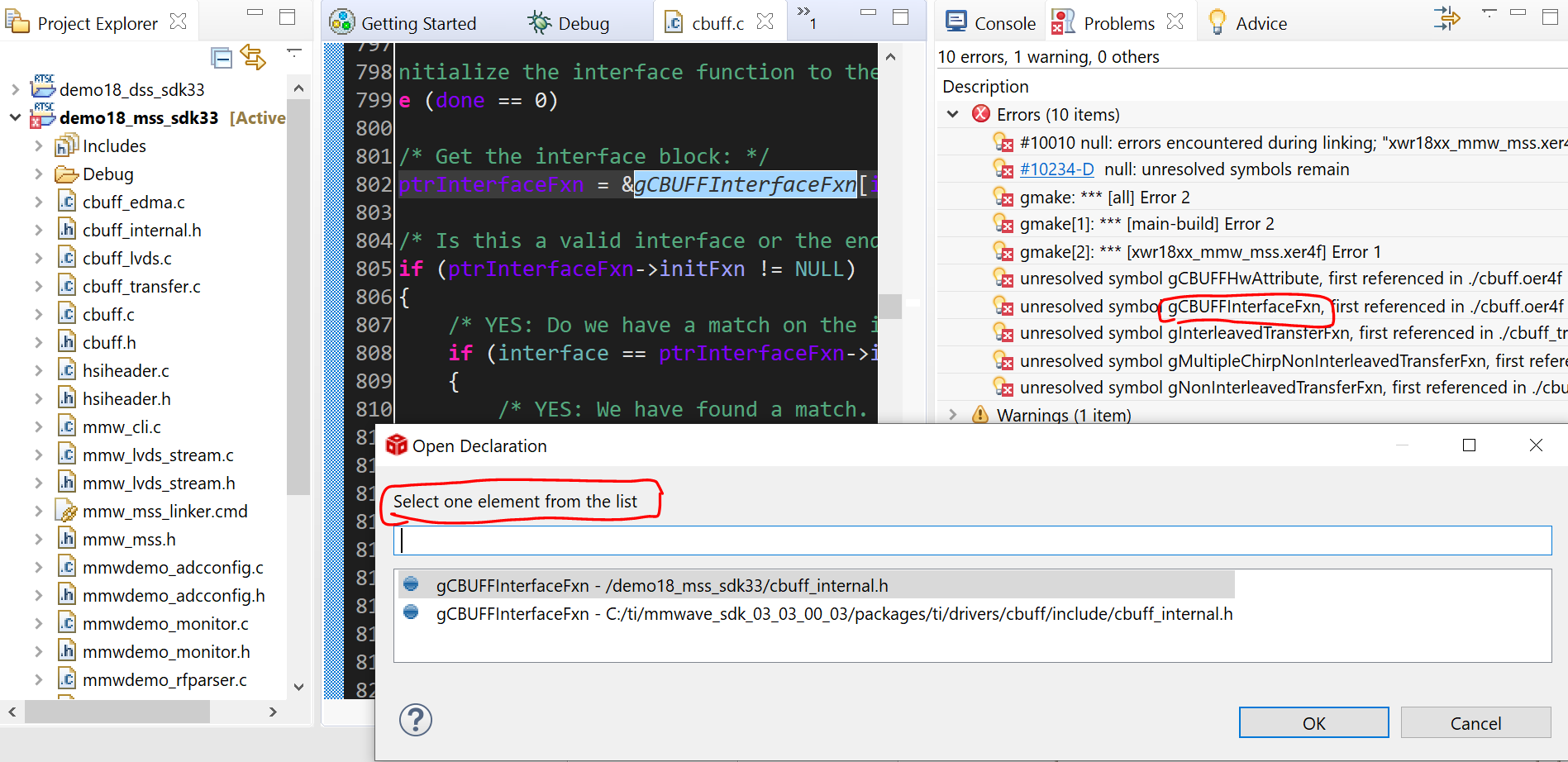

I want to test the LVDS streaming using SDK 3.3's mmw demo project. Since projectspec files were not present, I copied the available ones into the xwr18xx/mmw folder and modified the sdk version to 3.3 for the projectspec files.

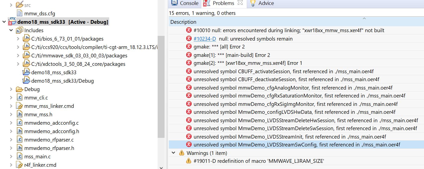

Now, when I compile the project using CCS, I get "unresolved symbols remain" error while rebuilding mss projectspec file. I've attached a screenshot of the console output for the reference. I tried to include the corresponding files (e.g.  #include <ti/drivers/cbuff/cbuff.h>  in the mmw_mss.h folder) to see if that helps in mitigating the issue, but it didn't.
I'm trying to understand why this few symbols are unresolved while others aren't, but haven't been able to narrow down as of now. It'd be great if you could please suggest why is it occurring?
Thank you
    You need to add the files where these symbols are defined in the projectspec file

  • Hi Cesar,
    It makes sense - thank you for the suggestion. While adding required files resolved the symbols in the screenshot - and a few more, the project is still running into unresolved symbols remain errors - and these errors are strange. I have attached a screenshot of it.
    These all symbols have origin in include\cbuff_internal.h file. Now, even if I include or I don't include this header file in the projectspec file, the error remains. On top of that, if I do incude, then when I locate the symbols and try opening the declaration, there are two conflicting references. One occurs because I included it, and the second occurs because of adding the /packages directory in compilerBuildOptions. I have also attached the created projectspec file for reference (I've changed the extension to .xml as the .projectspec isn't recognized on the portal).
    I tried multiple combinations, but these errors don't go away. I'm not sure what bug is in there. Please let me know if you have any solution for it. You may please try using the projectspec file to create MSS CCS project as well.
    Thank you
    Arvind

    Thank you for replying. The attached projectspec file is where I started working on this problem. Even after requisite modification, the "unresolved symbols remain" issue is present for five variables, and surprisingly, they all are declared in the cbuff_internal.h file.
     * Internal Exported Defintions:
    extern CBUFF_InterfaceFxn       gCBUFFInterfaceFxn[];
    extern CBUFF_Hw_Attrib          gCBUFFHwAttribute;
    extern CBUFF_setupTransferFxn   gInterleavedTransferFxn[];
    extern CBUFF_setupTransferFxn   gNonInterleavedTransferFxn[];
    extern CBUFF_setupTransferFxn   gMultipleChirpNonInterleavedTransferFxn[];
    Thanks.
    Sorry for the delay
    cbuff is a driver
    C:\ti\mmwave_sdk_03_03_00_03\packages\ti\drivers\cbuff\lib
    It should be included as a lib in the project similar to adcbuf for example
    -I${COM_TI_MMWAVE_SDK_INSTALL_DIR}/packages/ti/drivers/adcbuf/lib
