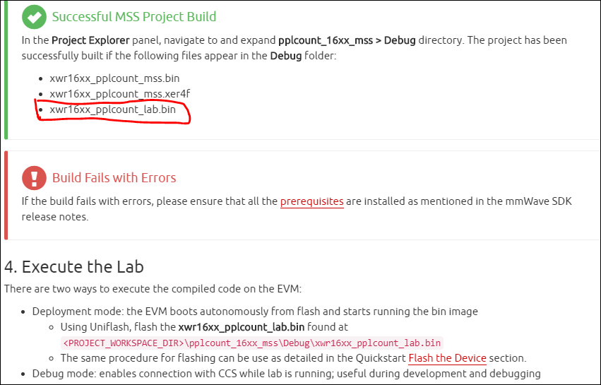

  • Hi Ana,
    It appears that you are flashing *_mss.bin which is not correct. You need to flash the combined meta-image binary file as highlighted below:

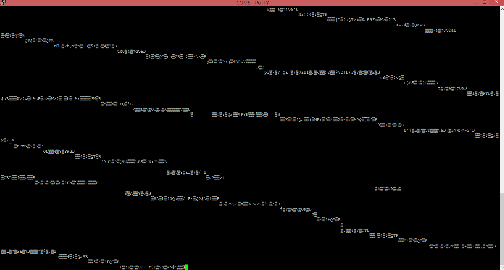

  • Hello Nitin,
    I changed to the default config and now i am receiving Data through the Data Port, but i am receiving the way it is in the print screen. What may be causing this?
    Ana Mattos
  • Hi Ana,
    This is expected since the data coming on UART is binary data (and not text information) which is meant to be processed/visualized by a Visualizer application. If you have not modified the output format, the GUI provided with the people counting demo should be able to process the data as usual. However, you will need to modify the GUI Matlab code to skip sending the target configuration as you are sending that in C code now.
