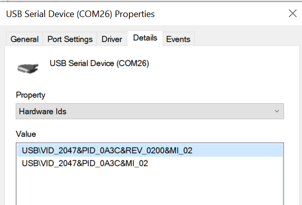

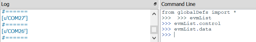

    Can you send hardware IDs for both com ports EVM shows up as?
    Can you also check control and data ports in command line of latte and send (see below)
    Can you also swap the USB cable and try with a fresh one to check that as well?

    I have attached info as requested. I have also tried a new USB cable but this did not solve the problem.

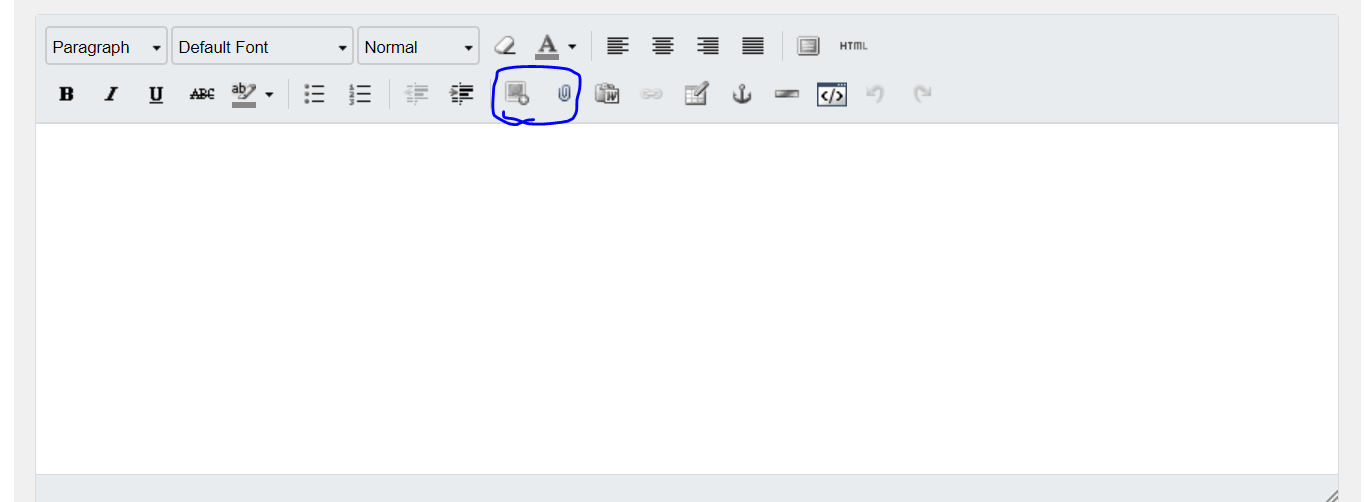

    By the way how do you attach screen shots. When I try and paste a screen shot of my PC from Word it does not attach to the post.
    Dave
    OPT3101 Control ID (COMM12)
    USB\VID_2047&PID_0A3C&REV_0200&MI_00
    USB\VID_2047&PID_0A3C&MI_00
    OPT3101 Data ID (COMM13)
    USB\VID_2047&PID_0A3C&REV_0200&MI_02
    USB\VID_2047&PID_0A3C&MI_02
    mEVMSelector.EVMSelector instance at 0x000000000EAACA08
    [u'COM12']
    [u'COM13']
  • Thanks for this. I will review and get back. For pictures use the left button in the blue circle. To add files use the right in the circle. You'll have to save the pictures to a file and then upload. Unfortunately paste does not work :(

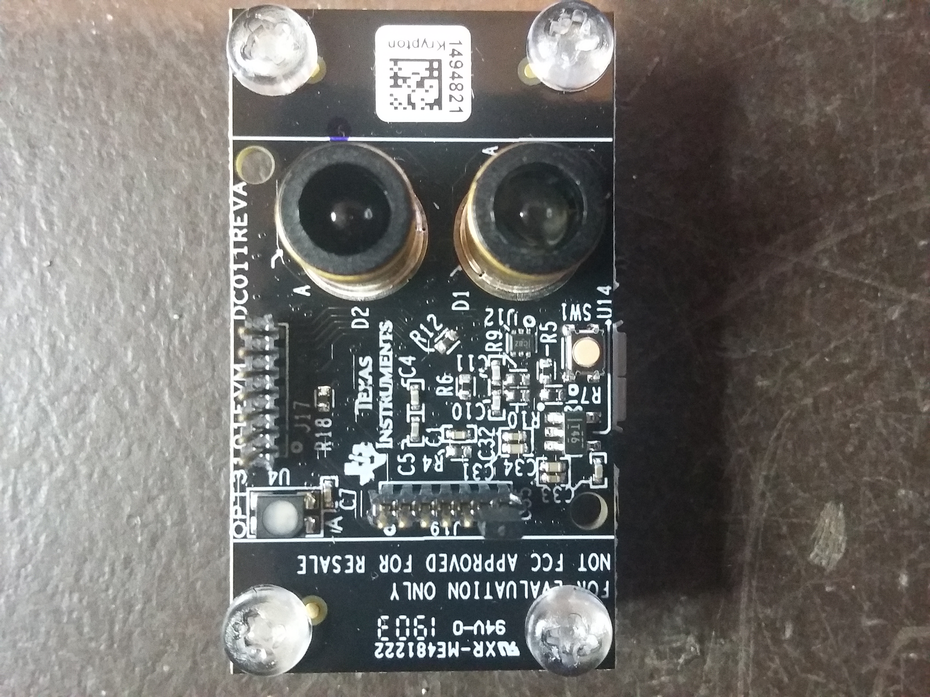

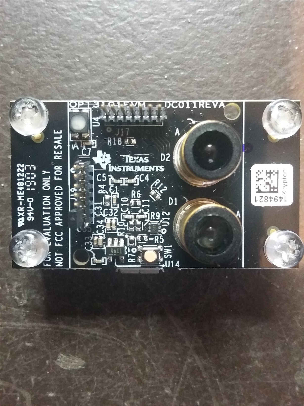

    Can you also share a picture of the EVM or confirm it matches the one here https://www.ti.com/tool/OPT3101EVM
    To check what state the device is in you can look on the LED switching node with a scope probe to look for the 10MHz switching
    You can also probe the data_ready line that is brought out to one of the headers (see schematic in users guide). The MSP430 is looking for this pulse to send data to the PC.

    I have had a probe around with an oscilloscope and there isn't any data_ready signal (the line is low) and there is no signal on the LED (permanently high).
    There is also no slave I2C signals. I have done the measurement with and without running the Capture button in Latte and there is no difference.

  • Hi Dave,
    Thanks for sending. I also wanted to confirm you have not modified anything in the latte software so it is as it come when downloaded? If this is the case I will look to ship you a new EVM to test. Are you able to provide your address for us to ship to? If rather not put on forum you can click on my profile and click the contact button to provide that way.
    Alex
  • In addition to your address can you also provide some background on your application/use-case and projected volume estimate.
    Alex
  • Hi Dave,
    I have submitted the EVM replacement request with your address and will follow up via direct message when it ships so will mark this post as resolved.
    Alex
