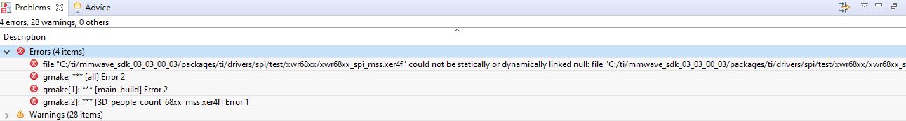

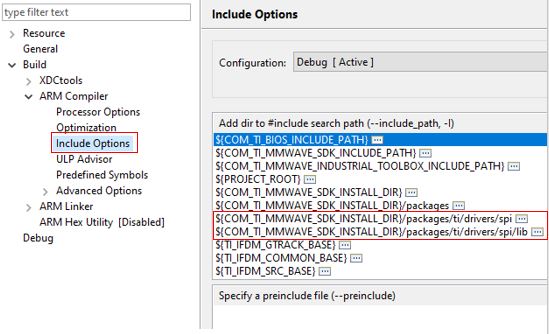

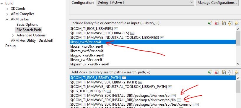

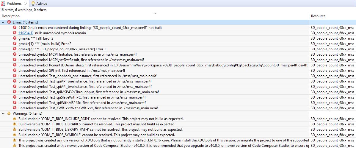

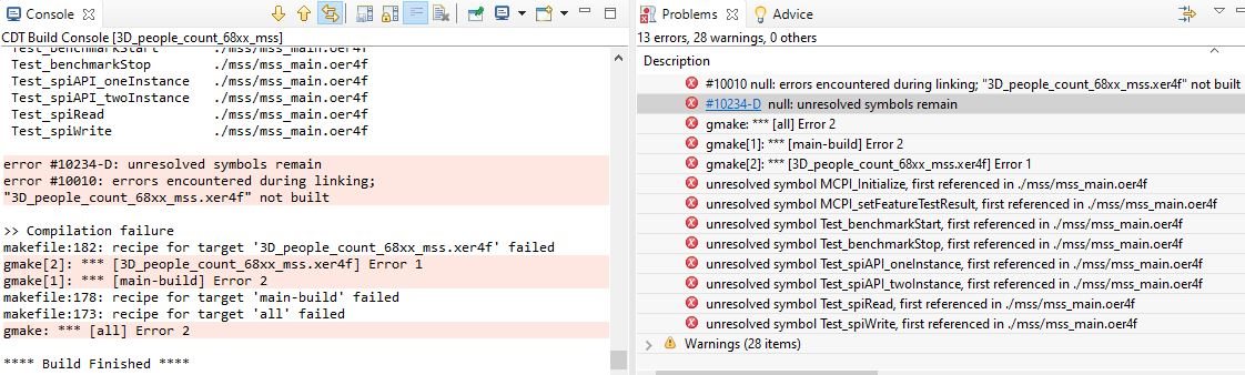

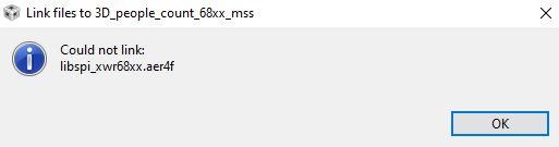

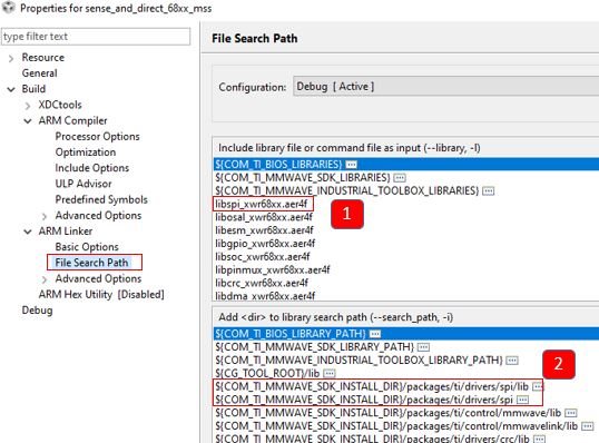

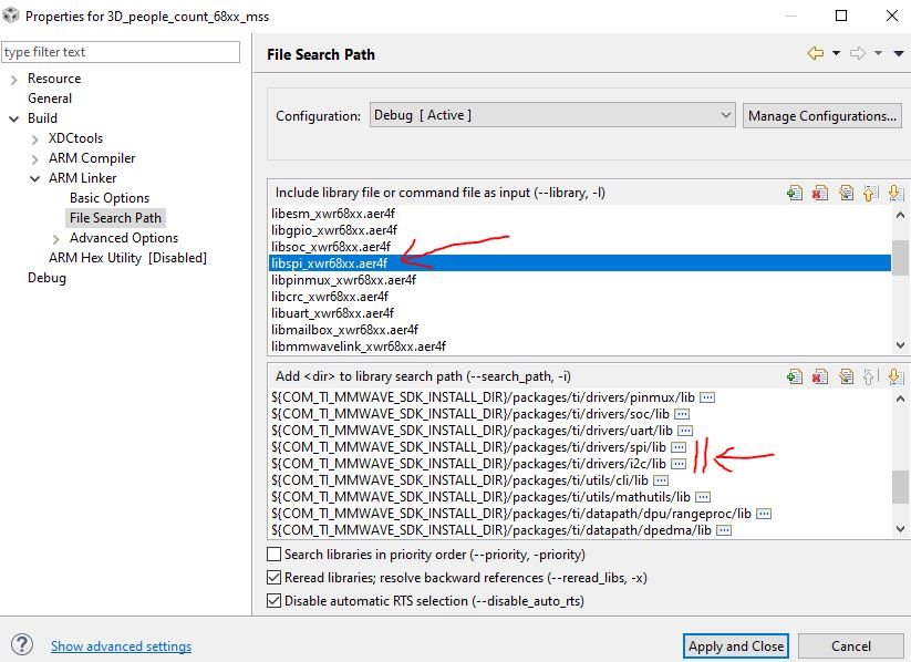

I'm trying to test SPI function on IWR6843. After finished pinmux settings, I modified the mss_main.c code of 3D people counting and added the SPI test code based on sample code in the path: C:\ti\mmwave_sdk_03_03_00_03\packages\ti\drivers\spi\test\xwr68xx
I already done SPI_init(), SPI_Params_init(&params);
But there were many errors occurred. Please explain (something like 3D_people_count_68xx_mss.xe4f not built, other errors and help me solve it.
Here's the code I used

  • Hi Hector,
    Your errors are all unresolved symbols. This means the linker cannot find a compiled version of the functions you are trying to use. For example, one of your errors is "Unresolved Symbol: SPI_init()" - this means that the SPI library isn't properly included or linked. Please check the following:
    • SPI and other new libraries are included in the relevant files
    • SPI and other new libraries have a path in linker properties.
      • Right click on the CCS project
      • Select Properties at the bottom
      • Select linker on the left
      • Ensure there is a path in the linker setting to spi lib
    Justin
  • Hi Justin,
    I added spi lib path to the project but compile still got the same error. Please show me how to solve it with illustration photo.
  • Hi Justin,
    I also tried another method to add library by clicking to mss project ->Properties->Add files. Then I chose libspi_xwr68xx.aer4f in the path C:\ti\mmwave_sdk_03_03_00_03\packages\ti\drivers\spi\lib.
    But it still showed
    #10010 null: errors encountered during linking; "3D_people_count_68xx_mss.xer4f" not built 3D_people_count_68xx_mss C/C++ Problem
    null: unresolved symbols remain 3D_people_count_68xx_mss C/C++ Problem
    Import a library should be easy. I don't know why it failed.
    Here's the message when I tried to add lib file to project

    I got less compiling error by adding xwr68xx_spi_mss.xer4f in the path C:\ti\mmwave_sdk_03_03_00_03\packages\ti\drivers\spi\test\xwr68xx to the project.
    Previously, I got 13 compile errors. After added xwr68xx_spi_mss.xer4f, now I only see 4 errors. Not sure whether this is better or not. But even if I don't use SPI function and remove all SPI commands, I still have these 4 errors after adding xwr68xx_spi_mss.xer4f to my project. If I don't add it, I only got compile error when I use SPI commands.
    How to solve it? I expect I can use SPI/I2C within this week, but I got stuck at library linking even though it seems to be easy.
    1. Here's the error after I added xwr68xx_spi_mss.xer4f
    error: "could not be statically or dynamically linked null: file "C:/ti/mmwave_sdk_03_03_00_03/packages/ti/drivers/spi/test/xwr68xx/xwr68xx_spi_mss.xer4f" could not be statically or dynamically linked 3D_people_count_68xx_mss C/C++ Problem
    2. Here's the error without xwr68xx_spi_mss.xer4f, I only added libspi_xwr68xx.aer4f in the path C:\ti\mmwave_sdk_03_03_00_03\packages\ti\drivers\spi\lib

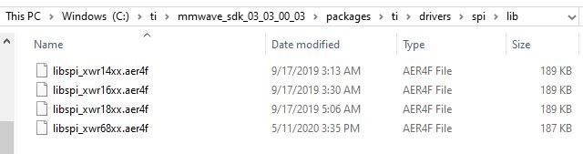

  • Hi Hector,
    You are linking the test library, instead you need to link the functional library. It is at: C:\ti\mmwave_sdk_03_03_00_03\packages\ti\drivers\spi\lib
    You can read mmWave SDK module documentation here: C:\ti\mmwave_sdk_03_03_00_03\docs\mmwave_sdk_module_documentation.html - if you go through the SPI documentation, you can see all external functions, which are the ones you should be using. Do not use the "Test" functions unless you are specifically trying to test the functionality of the module.
    Justin

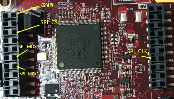

    - Connect the corresponding pins of 2 EVMs together. Only connect pins GND, CLK, CS, MOSI, MISO on J5 & J6 from EVM1 to corresponding pin on EVM2, right? Don't we need to connect pins 3v3 of each EVM together? As i know, we only need to connect 4 SPI pins for communication. But your colleague - woodall, told me to connect GND pins on J6 connector of 2 EVMs together. So I wanna ask when we need to connect GND, 3v3, 5V pins on J6 connector?

    Third, link files. You need to do the following to include a peripheral library:
    1. In the file using SPI, include SPI.h
    2. Ensure the path to SPI.h is properly defined
    3. Link the library file:
      1. You need to set the path to the .lib file. Make sure you select the right .lib, it needs to be the 68xx file.
      2. Make sure you also add the file name in the linked file section of CCS.
      3. Let me know if you don't know how to do this

  • Hi Hector,
    Your file search path is mostly correct, you don't need "${COM_TI_MMWAVE_INSTALL_DIR}/packages/ti/drivers/spi/" as the link is handled by the line directly below it which links to the lib folder.
    Second, the path "${COM_TI_MMWAVE_INSTALL_DIR}/packages/ti/drivers/spi/" should be included in the Compiler -> Include options tab (depending on how you have included the spi.h file in the source code).
    For the Pi3 and the XWR68 EVM, please ensure the grounds are connected, do not connect the voltage lines, power each one separately for now.
