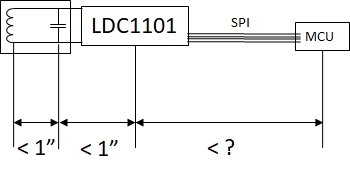

Hello there,
I would like to ask for recommendation of connection distances of entire sensor system?
As recommended in multiple LDC manuals it is best to place capacitor as close as possible to sensor coil. LDC should be also as close as possible to LC circuit. Ideally on the back of the coil. L to C max 1", LDC to LC max 1".
How far can be place MCU which sets registers and receives data from LDC? SPI runs at 8MHz. I know that SPI is mainly for short distance,  the closer the better but would it work reliably with shielded cables even on distance +-3 fl ? Here is the schematics:
Thank you.
