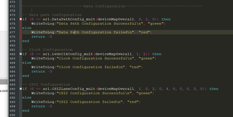

    For options like the LVDS/CSI2 lane configuration, I believe these can only be configured once without a device reset. At least that is my experience with the lua API/mmWave Studio and these options. In my normal usage of our single-device and cascaded EVM, I typically limit reconfiguration or looping of parameters only to the SensorConfig tab options (chirp profiles, chirp configs, frame config).
    I would also recommend modifying the setup script to select the exact options you need. The lines to modify for the ADC datapath are below.

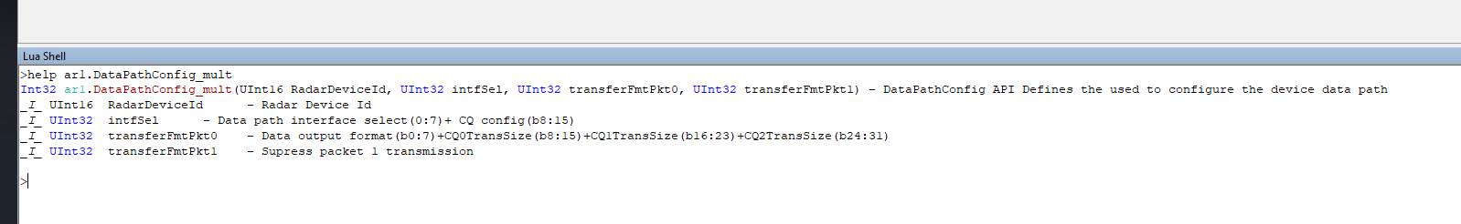

    2. You can look-up the full lua API parameter set from within mmWave Studio by using the Lua Shell and typing help and then the command. For example:

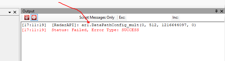

    1. You can also use the GUI selection and then read off the Output log window to find the function and parameters you need. For example clicking the Set button in the Data Path Configuration pane of the DataConfig tab results in the following API command being executed.
