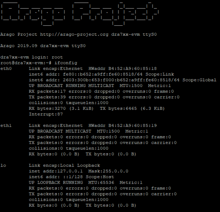

I am not able to ping my MMWCAS-DSP-EVM board with a direct Ethernet connection when I built the Linux Cascade Radar OS.
Using Ubuntu, I loaded the prebuilt Linux version and was able to ping the board so I know the physical connection is ok.
Here is my Ethernet connection on the Cascade board on the Linux I built:
  • Did you configure the EVM for static IP in your built?
    I think the pre-built binary is configured to get IP address from DHCP server.
  • I realize this. I said the prebuilt binary worked when I configured it to use a static address.
    I am talking about when I did the custom build of LInux. Has anyone at TI actually built the Linux version following the instructions and files your have provided and then tried to use the board? If so I would really like to see those instructions.
    https://e2e.ti.com/support/sensors/f/1023/t/899769 is another related issue.
  • Yes. The build instructions have been verified and that's how the pre-built binaries were generated.
    The building instructions can be found in Data Acquisition tool user guide.
    Please make sure uenv.txt file in SD card points to the below dtb.
    fdtfile=dra7-cascaderadar-infoadas.dtb

  • I did use this .dtb file as I said in the first section of https://e2e.ti.com/support/sensors/f/1023/t/899769 , otherwise Linux won't even boot so I would not get the ability to run the ifconfig command.
    I used "Vision SDK (v03.08.00) Linux User Guide" as was instructed in section 3 of "Vision SDK Linux Cascade Radar Data Acquisition Tool User Guide" to build Linux. There are no build instructions in this "Data Acquisition Tool User Guide" so I'm not sure what build instructions you are referring too.
    If you are refering to the Sys Bios/Ti Rtos build in "Vision SDK TDA2xx (v03.08.00) User Guide" and "Processor SDK Radar (v03.08) User Guide" I was able to succesfully build following these instructions, but I need the Linux build to work.
    Have you personally followed the build instructions with the git directories? It seems like someone built on their personal machine, uploaded the build output, and then forgot to check in files. That is just what it feels like to me.
    Tom
  • "Vision SDK (v03.08.00) Linux User Guide" is where you find the general build instructions to build Linux with the addition steps described in "Vision SDK Linux Cascade Radar Data Acquisition Tool User Guide" for cascade radar build.
    And, yes, I follow the same steps to build and have no issue with Ethernet connection.
    With your own build, can you get ip address from dhcp servier if you don't use static ip?
  • With a fresh build I cannot get an ip address from a DHCP server assuming you mean I should just plug the Ethernet cable into the router.
    What *nix are you building on? I am building on a Ubuntu VM. I wrote down all the steps I follow to complete the build which I can provide if that would help for debug.

    [    4.429455] systemd[1]: Proceeding WITHOUT firewalling in effect! (This warning is only shown for the first loaded unit using IP firewalling.)
    [    4.703704] systemd[1]: Created slice User and Session Slice.
    [  OK  ] Created slice User and Session Slice.
    [    4.740795] systemd[1]: Created slice system-serial\x2dgetty.slice.
    [  OK  ] Created slice system-serial\x2dgetty.slice.
    [    4.768674] systemd[1]: Reached target Remote File Systems.
    [  OK  ] Reached target Remote File Systems.
    [    4.798685] systemd[1]: Reached target Slices.
    [  OK  ] Reached target Slices.
    [    4.829114] systemd[1]: Listening on Journal Socket.
    [  OK  ] Listening on Journal Socket.
    [  OK  ] Started Forward Password Requests to Wall Directory Watch.
    [  OK  ] Listening on Journal Socket (/dev/log).
    [  OK  ] Reached target Swap.
             Mounting Kernel Debug File System...
             Mounting POSIX Message Queue File System...
             Starting Journal Service...
    [  OK  ] Started Dispatch Password Requests to Console Directory Watch.
    [  OK  ] Reached target Paths.
             Starting Load Kernel Modules...
    [  OK  ] Listening on udev Kernel Socket.
             Mounting Temporary Directory (/tmp)...
    [  OK  ] Listening on udev Control Socket.
    [  OK  ] Listening on Network Service Netlink Socket.
             Starting Remount Root and Kernel File Systems...
    [    5.362839] EXT4-fs (mmcblk0p2): re-mounted. Opts: (null)
             Starting udev Coldplug all Devices...
    [  OK  ] Listening on Process Core Dump Socket.
    [  OK  ] Created slice system-getty.slice.
    [  OK  ] Listening on initctl Compatibility Named Pipe.
    [  OK  ] Started Journal Service.
    [  OK  ] Mounted Kernel Debug File System.
    [  OK  ] Mounted POSIX Message Queue File System.
    [FAILED] Failed to start Load Kernel Modules.
    See 'systemctl status systemd-modules-load.service' for details.
    [  OK  ] Mounted Temporary Directory (/tmp).
    [  OK  ] Started Remount Root and Kernel File Systems.
             Starting Create Static Device Nodes in /dev...
             Starting Apply Kernel Variables...
             Mounting Kernel Configuration File System...
             Starting Flush Journal to Persistent Storage...
    [  OK  ] Started Create Static Device Nodes in /dev.
    [  OK  ] Started Apply Kernel Variables.
    [  OK  ] Mounted Kernel Configuration File System.
    [    5.969928] systemd-journald[95]: Received request to flush runtime journal from PID 1
    [  OK  ] Reached target Local File Systems (Pre).
             Mounting /var/volatile...
    [  OK  ] Reached target Containers.
             Mounting /media/ram...
             Starting udev Kernel Device Manager...
    [  OK  ] Started Flush Journal to Persistent Storage.
    [  OK  ] Mounted /var/volatile.
    [  OK  ] Mounted /media/ram.
    [  OK  ] Started udev Kernel Device Manager.
             Starting Load/Save Random Seed...
    [  OK  ] Reached target Local File Systems.
             Starting Create Volatile Files and Directories...
    [  OK  ] Started Load/Save Random Seed.
    [  OK  ] Started udev Coldplug all Devices.
    [  OK  ] Started Create Volatile Files and Directories.
             Starting Network Time Synchronization...
             Starting Update UTMP about System Boot/Shutdown...
             Starting Network Service...
    [    6.740888] omap-rproc 55020000.ipu: ignoring dependency for device, assuming no driver
    [    6.773981] omap-rproc 55020000.ipu: ignoring dependency for device, assuming no driver
    [  OK  ] Started Update UTMP about System Boot/Shutdown.
    [    6.848920] omap-rproc 55020000.ipu: assigned reserved memory node ipu2-memory@95800000
    [    6.914595] remoteproc remoteproc0: 55020000.ipu is available
    [    6.953779] omap-rproc 40800000.dsp: ignoring dependency for device, assuming no driver
    [    7.001542] omap-rproc 40800000.dsp: ignoring dependency for device, assuming no driver
    [    7.058107] omap-rproc 40800000.dsp: assigned reserved memory node dsp1-memory@99000000
    [    7.109072] remoteproc remoteproc1: 40800000.dsp is available
    [    7.153759] remoteproc remoteproc1: Direct firmware load for dra7-dsp1-fw.xe66 failed with error -2
    [    7.168115] omap-rproc 41000000.dsp: ignoring dependency for device, assuming no driver
    [    7.213873] remoteproc remoteproc1: powering up 40800000.dsp
    [    7.226427] omap-rproc 41000000.dsp: ignoring dependency for device, assuming no driver
    [    7.239616] remoteproc remoteproc1: Direct firmware load for dra7-dsp1-fw.xe66 failed with error -2
    [    7.271456] omap-rproc 41000000.dsp: assigned reserved memory node dsp2-memory@9f000000
    [    7.284787] remoteproc remoteproc1: request_firmware failed: -2
    [    7.312809] remoteproc remoteproc2: 41000000.dsp is available
    [  OK  ] Found device /dev/ttyS0.
    [    7.327628] remoteproc remoteproc2: Direct firmware load for dra7-dsp2-fw.xe66 failed with error -2
    [    7.404915] remoteproc remoteproc2: powering up 41000000.dsp
    [    7.421855] remoteproc remoteproc2: Direct firmware load for dra7-dsp2-fw.xe66 failed with error -2
    [    7.444964] remoteproc remoteproc2: request_firmware failed: -2
    [    7.480107] remoteproc remoteproc0: powering up 55020000.ipu
    [    7.487234] remoteproc remoteproc0: Booting fw image dra7-ipu2-fw.xem4, size 4391400
    [    7.496751] omap-iommu 55082000.mmu: 55082000.mmu: version 2.1
    [    7.552336] virtio_rpmsg_bus virtio0: rpmsg host is online
    [    7.557900] remoteproc remoteproc0: registered virtio0 (type 7)
    [    7.565695] remoteproc remoteproc0: remote processor 55020000.ipu is now up
    [    7.573124] Driver for 1-wire Dallas network protocol.
    [    7.601766] virtio_rpmsg_bus virtio0: creating channel rpmsg-proto addr 0x50
    [    7.641010] omap_rtc 48838000.rtc: registered as rtc0
    [  OK  ] Started Network Service.
    [    7.698051] net eth1: initializing cpsw version 1.15 (0)
    [  OK  ] Started Network Time Synchronization.
    [    7.730336] libphy: PHY 48485000.mdio:03 not found
    [  OK  ] Reached target System Initialization.
    [    7.748459] net eth1: phy "48485000.mdio:03" not found on slave 1, err -19
    [    7.789844] omap_hdq 480b2000.1w: OMAP HDQ Hardware Rev 0.:. Driver in Interrupt mode
    [    7.801900] IPv6: ADDRCONF(NETDEV_UP): eth1: link is not ready
    [    7.831463] net eth0: initializing cpsw version 1.15 (0)
    [  OK  ] Listening on dropbear.socket.
    [  OK  ] Listening on Avahi mDNS/DNS-SD Stack Activation Socket.
    [    7.878144] omap-des 480a5000.des: OMAP DES hw accel rev: 2.2
    [  OK  ] Started Daily Cleanup of Temporary Directories.
    [    7.913900] omap-des 480a5000.des: will run requests pump with realtime priority
    [  OK  ] Reached target Timers.
    [  OK  ] Listening on D-Bus System Message Bus Socket.[    7.952650] TI DP83867 48485000.mdio:02: attached PHY driver [TI DP83867] (mii_bus:phy_addr=48485000.mdio:02, irq=POLL)
    [  OK  ] Reached target Sockets.
    [    8.007503] IPv6: ADDRCONF(NETDEV_UP): eth0: link is not ready
    [  OK  ] Reached target Basic System.
    [    8.026216] phy phy-4a084000.phy.4: Linked as a consumer to regulator.25
    [    8.033142] w1_master_driver w1_bus_master1: Attaching one wire slave 01.000000000000 crc 3d
             Starting rc.pvr.service...
             Starting TI IPC Daemon...
    [    8.068997] phy phy-4a085000.phy.5: Linked as a consumer to regulator.25
    [    8.097055] w1_master_driver w1_bus_master1: Family 1 for 01.000000000000.3d is not registered.
    [  OK  ] Started D-Bus System Message Bus.
             Starting Login Service...
    [  OK  ] Reached target System Time Synchronized.
             Starting Network Name Resolution...
    [  OK  ] Started TI IPC Daemon.
    [    8.406302] omap-sham 4b101000.sham: hw accel on OMAP rev 4.3
    [    8.426469] omap-aes 4b500000.aes: OMAP AES hw accel rev: 3.3
    [    8.451898] omap-aes 4b500000.aes: will run requests pump with realtime priority
    [    8.529811] omap-aes 4b700000.aes: OMAP AES hw accel rev: 3.3
    [    8.549788] omap-aes 4b700000.aes: will run requests pump with realtime priority
    [    9.273277] CAN device driver interface
    [    9.304038] pvrsrvkm: loading out-of-tree module taints kernel.
    [    9.352455] pvrsrvkm 56000000.gpu: assigned reserved memory node gpu-memory@c0000000
    [    9.409691] [drm] Initialized pvr 1.17.4948957 20110701 for 56000000.gpu on minor 2
    [    9.566983] ahci 4a140000.sata: controller can't do 64bit DMA, forcing 32bit
    [    9.584685] ahci 4a140000.sata: forcing port_map 0x0 -> 0x1
    [    9.602175] ahci 4a140000.sata: AHCI 0001.0300 32 slots 1 ports 3 Gbps 0x1 impl platform mode
    [    9.618649] ahci 4a140000.sata: flags: ncq sntf pm led clo only pmp pio slum part ccc apst
    [    9.635629] c_can_platform 4ae3c000.can: c_can_platform device registered (regs=145a91c5, irq=90)
    [    9.687076] scsi host0: ahci
    [    9.695991] ata1: SATA max UDMA/133 mmio [mem 0x4a140000-0x4a1410ff] port 0x100 irq 79
    [    9.790580] PVR_K: UM DDK-(4948957) and KM DDK-(4948957) match. [ OK ]
    [  OK  ] Started Login Service.
    [  OK  ] Started Network Name Resolution.
    [  OK  ] Started rc.pvr.service.
    [   10.053470] ata1: SATA link down (SStatus 0 SControl 300)
    [   11.806124] NET: Registered protocol family 45
    [   12.165316] cpsw 48484000.ethernet eth0: Link is Up - 1Gbps/Full - flow control rx/tx
    [   12.173274] IPv6: ADDRCONF(NETDEV_CHANGE): eth0: link becomes ready
    [  OK  ] Listening on Load/Save RF Kill Switch Status /dev/rfkill Watch.
    [  OK  ] Created slice system-systemd\x2dfsck.slice.
             Starting File System Check on /dev/mmcblk0p1...
             Starting File System Check on /dev/nvme0n1p1...
             Starting weston.service...
    [  OK  ] Reached target Host and Network Name Lookups.
    [  OK  ] Reached target Network.
             Starting Permit User Sessions...
             Starting Avahi mDNS/DNS-SD Stack...
    [  OK  ] Started File System Check on /dev/mmcblk0p1.
             Mounting /run/media/mmcblk0p1...
    [  OK  ] Started Permit User Sessions.
    [  OK  ] Started Getty on tty1.
    [  OK  ] Started Serial Getty on ttyS0.
    [  OK  ] Reached target Login Prompts.
             Starting Synchronize System and HW clocks...
    [  OK  ] Started weston.service.
             Starting telnetd.service...
    [  OK  ] Started Synchronize System and HW clocks.
    [  OK  ] Started telnetd.service.
    [  OK  ] Started Avahi mDNS/DNS-SD Stack.
    [  OK  ] Reached target Multi-User System.
             Starting Update UTMP about System Runlevel Changes...
    [  OK  ] Started File System Check on /dev/nvme0n1p1.
    [   15.510431] FAT-fs (mmcblk0p1): Volume was not properly unmounted. Some data may be corrupt. Please run fsck.
    [  OK  ] Mounted /run/media/mmcblk0p1.
             Mounting /run/media/nvme0n1p1...
    [  OK  ] Started Update UTMP about System Runlevel Changes.
    [   15.663082] EXT4-fs (nvme0n1p1): mounted filesystem with ordered data mode. Opts: (null)
    [  OK  ] Mounted /run/media/nvme0n1p1.
     _____                    _____           _         _
    |  _  |___ ___ ___ ___   |  _  |___ ___  |_|___ ___| |_
    |     |  _| .'| . | . |  |   __|  _| . | | | -_|  _|  _|
    |__|__|_| |__,|_  |___|  |__|  |_| |___|_| |___|___|_|
                  |___|                    |___|
    Arago Project http://arago-project.org dra7xx-evm ttyS0
    Arago 2019.09 dra7xx-evm ttyS0
    dra7xx-evm login: root
    Thanks.
    Tom
  • From the log, it looks like the Ethernet is up.
    Could you try using pre-built u-boot with the kernel you built?
    3331a8a6168f5838b24c273d59fa24c2049bd02c
  • Hello Stanley,
    I tried using the prebuilt u-boot from PROCESSOR_SDK_CASCADE_RADAR_03_08_00_00_prebuilt.exe but I got the same results (no Ethernet connection when connected directly to router).
    My checksum does not match what you are providing though. Where did you get the u-boot?
    Tom
  • Hi Tom,
    Sorry for not responding earlier. I was OOO for some time.
    Could you compare one register value between the working build vs non-working build?
    The register to check is CTRL_MODULE_CTRL_CORE_SMA_SW_1 @ 0x4A002534.
    You can read register value in Linux by giving command "./ompaconf read 0x4a002534".
    Stanley
  • Hi Stanley,
    No problem and thanks for following up.
    I could not find the "ompaconf" command so I wasn't able to read this register. Do you know where this file is?
    I think this issue can be closed for now. We are just going to use the stock Arago Linux build for development for the near term.
    Tom
  • Thanks for the update.
    You can find the tool here. https://github.com/omapconf/omapconf
