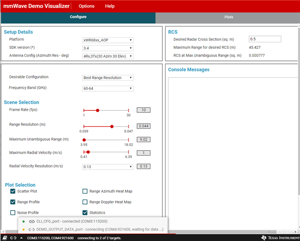

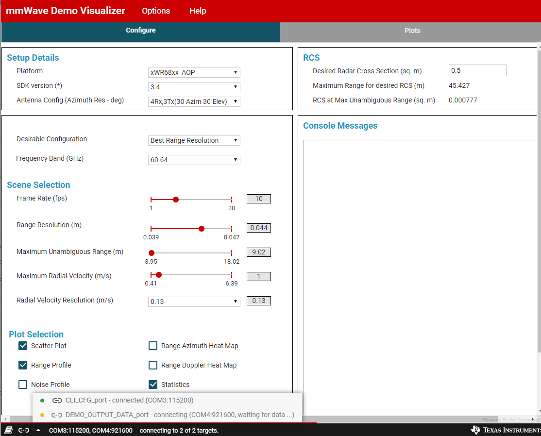

Until today all was fine, however I wanted to update some parameters in the config and went to the demo visualiser where I could not connect.
Realising that there was an updated SDK version I opted to upgrade using uniflash which was successful.
Upon going back to the visualiser again this was the state.

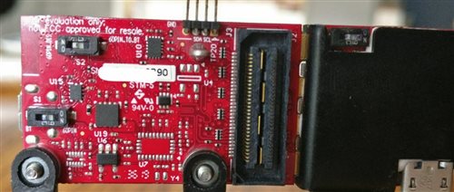

For completeness -> here are the settings of the switches:
The weird thing is, when I switch the 2 switch of the double (SW1-2) it seems to see the data and not the config.
I have tried sending the config without the data port, this however did not solve it.
My own code seems to be able to send the config files I had, however does not get anything from the dataport either.
