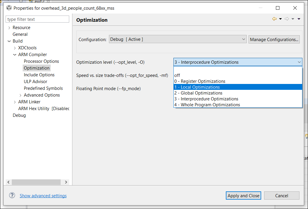

  • Hi Denis,
    I had provided you an alternate method to hard-code sensor configuration by modifying the cli lib, in response to your other thread. Please use that method. We do not have an example of hard-coding the config using the above approach at this time.
    In general, regarding this exception or any debugging in general, it's very hard to comment on the cause of the exception just by looking at code. You will need to narrow it down by stepping into the code and localizing it to a function or line.
    You will first need to compile the code to enable statement level stepping (debug). The default options in the project use -O3 optimization which does not allow statement level debug so please change it to level 1 ( in CCS after importing the project) as shown below, and rebuild the project.
    -Nitin

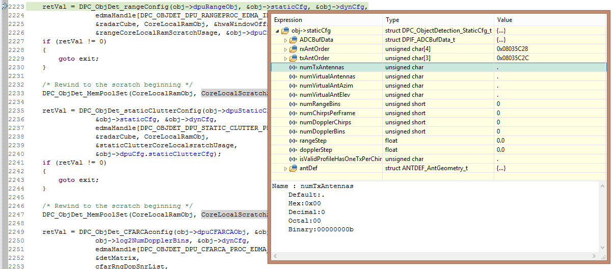

  • Hello again, Nitin!
    There is no optimization in my project (Optimization Level - off). And it is important for our project not to use any CLI functions (includeing modified CLI lib files).
    Here is call stack when error occurs.
    Apperently error happens in DPC_ObjDet_rangeConfig function, because staticCfg passed to this function has zeroes in all fields (including numTxAntennas, which makes hwRes->dcRangeSigMeanSize equal to 0 which then leads to MemoryP_ctrlAlloc error).
    Here is DPC_ObjDet_rangeConfig call in debugger
    That is strange because staticCfg does have correct fields when it's passed to DPC_ObjDet_preStartConfig.
    Inside DPC_ObjDet_preStartConfig before DPC_ObjDet_rangeConfig call, staticCfg is assigned to corresponding field of SubFrameObj *obj. After this assignment all fields turned to 0. Here is right hand side (RHS) and left hand side (LHS) of this assignment
    When I debug ods_point_cloud_68xx_hwa lab, at this line RHS and LHS of assignment are identical.
    Pretty strange issue.
